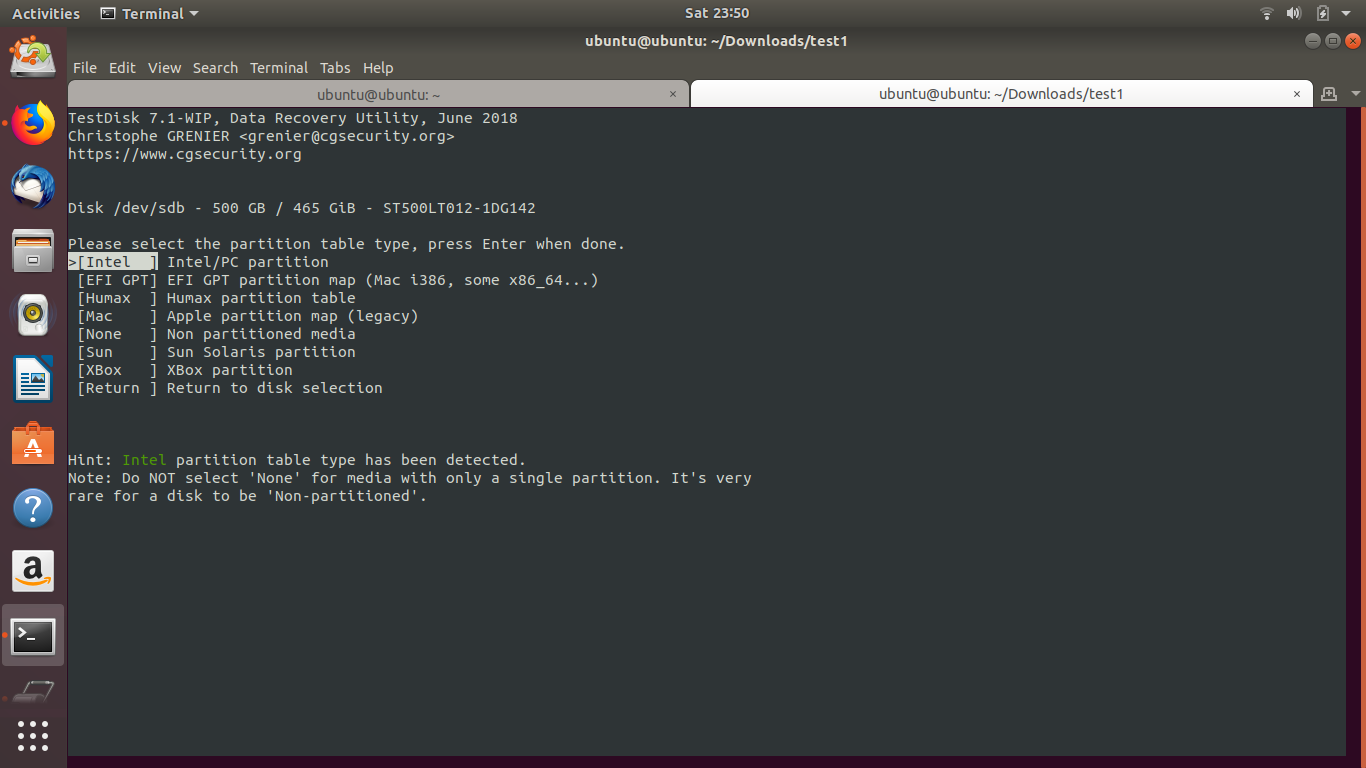

I downloaded test-disk and ran that where in the first menu displays
I am not sure of the files the say Disk/dev/loop0-7 mean but I know my Seagate is 500G so I select it
and presented with
https://imgur.com/a/xk5rSnY
the program detects Intel. I thought the system was UEFI and therefore GPT but perhaps someone can clear up what this means
so this is where I see Image
i can quicksearch or backup so I try quicksearch
then I see a Linux LVM option which does not find any partitions
but when click deepsearch this is screen I see https://imgur.com/a/xk5rSnY
this is where I am stuck. I did this same process yesterday but found the windows10 partition named OS but it
I still was not able to boot. Any help would be appreciated
Screenshot from 2018-10-13 23-50-08.png (124.11 KiB) Viewed 1682 times
Re: Dual Boot System Windows 10/LM19 no bootable device / Partition Recovery
The partition table looks OK. You may have to activate your LVM with
<pre>
sudo pvdisplay
sudo vgdisplay
sudo vgchange -a y
sudo lvdisplay
</pre>
