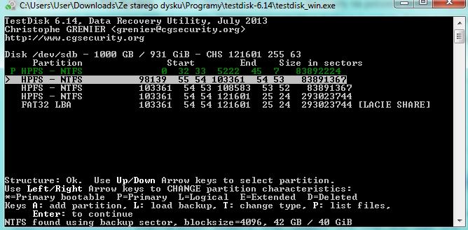

After 8 years of keeping the old Lacie/Western Digital 1 TB external drive in a box, I decided to bring it back to life. As I remember, a friend of mine connected the drive to the Mac and accidentally agreed to the NTFS to HFS+ partition format. I don't remember if he tried to restore it to NTFS afterward, but at the moment this is how Testdisk recognizes it after deep scanning:
https://ibb.co/tHfPPS3
Photorec probably found all the files that were on the disk, so I had hope that the partition could be restored as well. Fix CHKDSK didn't help. So I decided to use Testdisk. The sectors were not identical, so I tried unsuccessfully to boot from the original sector and then rebuild it. Now they're identical, but when I trying to open a missing disk partition in NTFS (there is also "Lacie Share" partiition in FAT 32) in windows explorer the system suggests that it is damaged and unreadable. Also the list (P) after a deep Testdik scan doesn't let me browse the files ("Can't open filesystem. Filesystem seems damaged"). MBR and MFT repairs did not help either.
Although I cannot view the list of files after a deep scan, the write option is still available. Does it make sense to fight, or should I give up and this disk should be formatted?

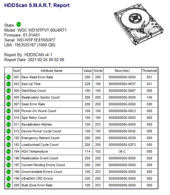

This is what the SMART analysis looks like
https://ibb.co/qssqdYg
And here is the beginning of the Testdisk log:
Disk /dev/sdb - 1000 GB / 931 GiB - WDC WD10 TPVT-00U4RT1
NTFS at 0/32/33
Info: size boot_sector 83891367, partition 1660495872
FAT32 at 103361/54/54
Info: size boot_sector 293023744, partition 293023744
FAT1 : 32-35792
FAT2 : 35793-71553
start_rootdir : 71554 root cluster : 2
Data : 71554-293023681
sectors : 293023744
cluster_size : 64
no_of_cluster : 4577377 (2 - 4577378)
fat_length 35761 calculated 35761
1 * HPFS - NTFS 0 32 33 103361 54 53 1660495872
NTFS, blocksize=4096, 850 GB / 791 GiB
2 P FAT32 LBA 103361 54 54 121601 25 24 293023744 [LACIE SHARE]
FAT32, blocksize=32768, 150 GB / 139 GiB
Not an exFAT boot sector.
ntfs_boot_sector
NTFS at 0/32/33
NTFS at 0/32/33
filesystem size 83891367
mftmirr_lcn 5243210
Status: OK
Status: OK
Sectors are identical.
$MFT has invalid magic.
ntfs_mft_load(): Failed.

I don't know if the Input/output error is caused by failed sectors or by data pointing to a location beyond the end of the disk.
You might produce a smartmontools log file that you can post here to check for errors.

I can't see your pictures unfortunately - please upload them to this site using the attachment tab.

Your smartmontools report does not show any visible sign of dammage of your disk.
