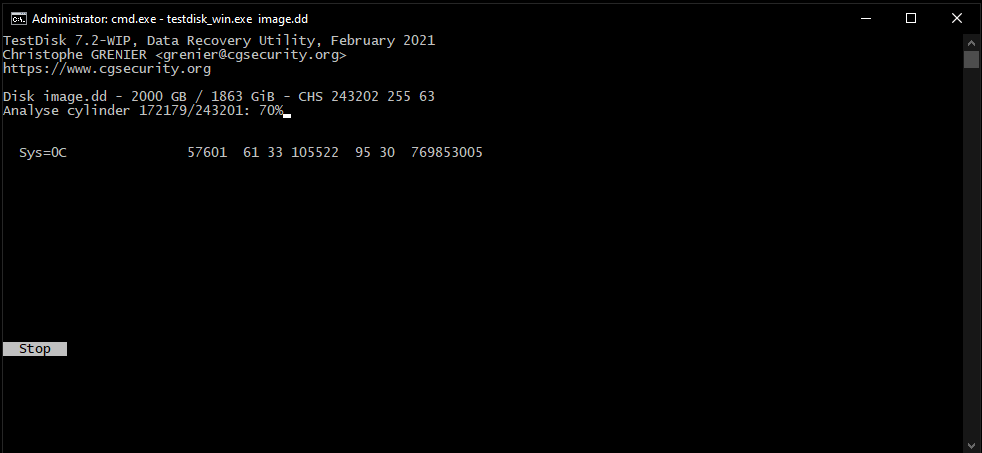

Interesting. I no longer have the drive powered on and am just working from the image. Speaking of that, TestDisk has been analyzing the image.dd since around 6pm yesterday and is only still at 70%. Don't know if this is normal and I should let it continue, or if these attempts are futile...
Also, would you know if a professional data recovery service would still be a viable option at this point?
- TestDiskImage.DD.PNG (15.19 KiB) Viewed 6028 times
