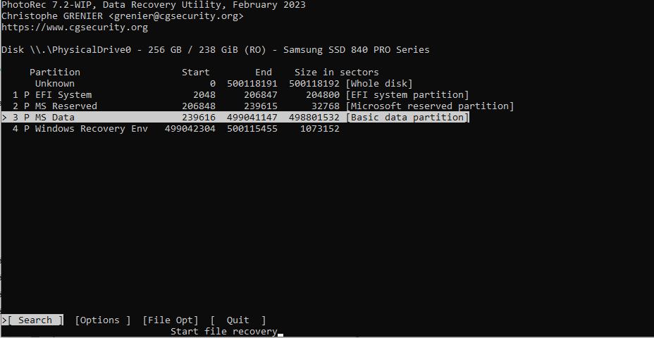

Sorry i don't want to annoy you but i'm feeling really stupid now. Wrong drive? I'll post 2 screenshots of how i used Photorec: On first Screenshot you'll see my Harddrives, i selected the 840 Pro there, Second Screenshot shows the Partitions on it.. I wanted to recover files of the 3rd Parition (which didn't work yesterday).
So i used smartmontools and scanned the 840 Pro drive. I did it just now again with the same results. What am i doing wrong here?

Re: photorec will just stop at the same spot
I was wrong and had the other open posting in mind.
Which version of Photorec are you using?
How long did you wait after assuming that Photorec was stuck?
I'm using the one included in the Testdisk7.2.WIP package. I waited for about 20-30 Minutes. This morning when i tried it it instantly worked and it didn't even stop at any point. So i guess it was all just related to me not restarting the system before.
