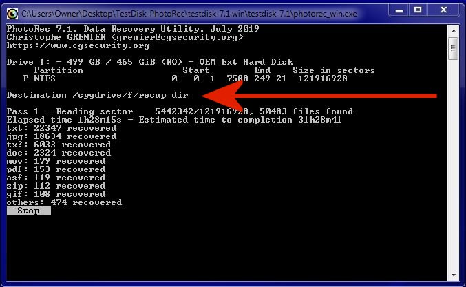

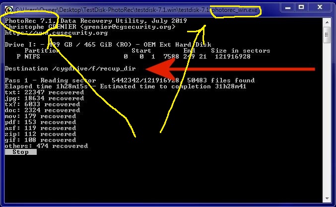

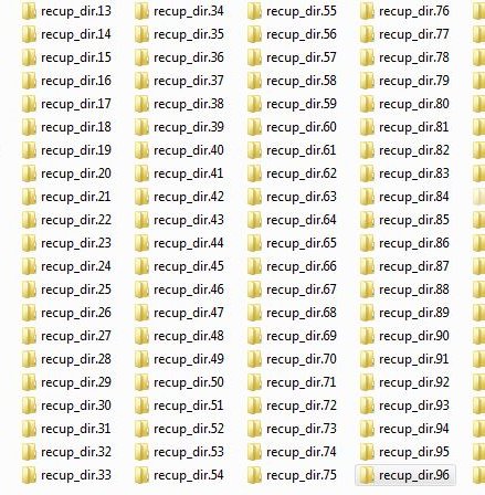

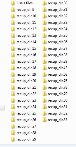

I hesitated to ever come back here after all the uproar informing me TestDisk did not create folders with names like recup_dir.xxx when that was exactly what happened. I'm going to try to upload some screenshots of what PhotoRec did, etc., then get out of here before I get in trouble again. I can't explain why those folders were named like they were. Was it because that Iomega drive was set up differently? I don't know. All I know is that both TestDisk and PhotoRec were very similar in their output. The BIG difference was that PhotoRec did not post all those extra folders that had something like 433 folders, all repeating the same 3 files over and over and over. I documented that earlier in these posts. I also found that PhotoRec found the same first 8 folders that TestDisk did, which contained lessons from my daughter's biology class. Basically from that point on it repeated what TestDisk found. Remember, Testdisk posted 517 folders. I deleted the extra 433 folders that contained the same 3 images repeated endlessly, and moved my daughter's lesson files into a separate folders, which were in the first 8 folders. I do have a pic of the remaining folders, recup_dir.9 - recup_dir.83. I'll try to post that. I couldn't get all the folders in the pic from Photo_Rec, but have most. That posted a total of 101 folders, a lot more efficient in finding images that TestDisk in my experience. I have a pic of the beginning of PhotoRec as it's getting ready to scan the Iomega drive and one (before and after with arrow) at the end where it shows what the names of the folders are going to be. Sorry, but it shows the folders will be named as I have already pointed out. Now to try to post the images, then get out of here.
I can only post 3 images so I'll just post the pic of the TestDisk folders, PhotoRec with the arrow and most of the folders it created. I could probably find out why I can only post 3 pics if I stopped and asked but I have no desire to even be here.

Thank you for providing a proof that you did run Photorec:
Based on the additional information contained in your picture you are running the outdated and unsupported version 7.1.
Use version 7.2-WIP. This is not betaware but the result of continuous small improvements and bugfixes.
It could very well be that the version of Photorec contained in the 7.2-WIP package won't run into an endless loop.
