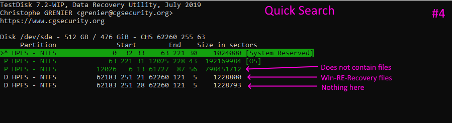

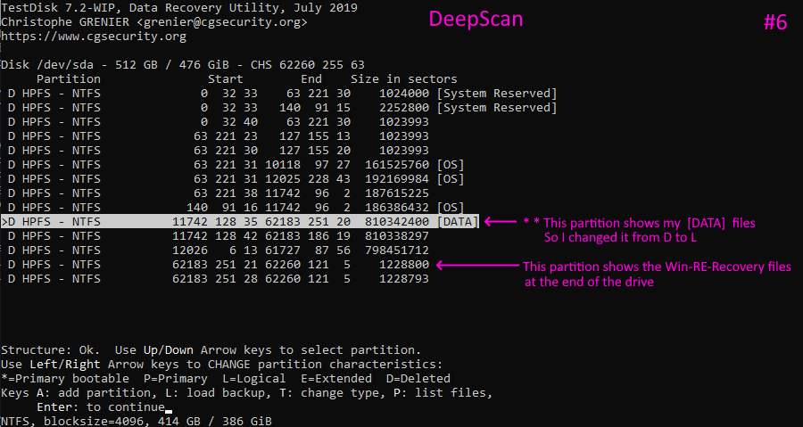

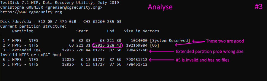

I ran TestDisk and think I found the missing partitions, but I'm not sure what to do as it looks like it might overlap some partitions.
The problem is shown in the last (#6 & #7) screenshots.
Please follow the screen shots below.

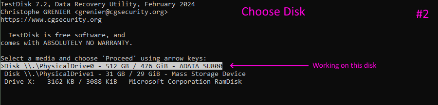

Running TestDisk :
2 - 60A-TestDisk - ChooseDisk.png (23.17 KiB) Viewed 32035 times
3 - 2A-TestDisk - Analyse.png (34.9 KiB) Viewed 32035 times
4 - 2B-TestDisk - QuickSearch.png (29.79 KiB) Viewed 32034 times
6 - 2C-TestDisk - DeepScan.png (61.25 KiB) Viewed 32034 times
7 - 50A-TestDisk - pre-Write.png (45.12 KiB) Viewed 32030 times
So as I wrote above in the #7 screenshot :
  • No write was completed (meaning I didn't do it), and
  • How do I keep the Extended Partition 11742-96-3 -- 62183-251-20 from overlapping (starting before) the end of 2nd [OS] partition 63-221-31 -- 12025-228-43 ?

     NTFS found using backup sector, blocksize=4096, 98 GB / 91 GiB
     HPFS - NTFS          12026   6 13 61727  87 56  798451712
NTFS at 62183/186/19
filesystem size           810338297

     HPFS - NTFS              0  32 33    63 221 30    1024000 [System Reserved]
     NTFS, blocksize=4096, 524 MB / 500 MiB
     HPFS - NTFS              0  32 33   140  91 15    2252800 [System Reserved]
     NTFS found using backup sector, blocksize=4096, 1153 MB / 1100 MiB
     HPFS - NTFS              0  32 40    63 221 30    1023993
     NTFS found using backup sector, blocksize=4096, 524 MB / 499 MiB
     HPFS - NTFS             63 221 23   127 155 13    1023993
     NTFS, blocksize=4096, 524 MB / 499 MiB
     HPFS - NTFS             63 221 30   127 155 20    1023993
     HPFS - NTFS             63 221 31 10118  97 27  161525760 [OS]
     NTFS found using backup sector, blocksize=4096, 82 GB / 77 GiB
     HPFS - NTFS             63 221 31 12025 228 43  192169984 [OS]
     NTFS, blocksize=4096, 98 GB / 91 GiB
     HPFS - NTFS             63 221 38 11742  96  2  187615225
     NTFS found using backup sector, blocksize=4096, 96 GB / 89 GiB
     HPFS - NTFS            140  91 16 11742  96  2  186386432 [OS]
     NTFS, blocksize=4096, 95 GB / 88 GiB
     HPFS - NTFS          11742 128 35 62183 251 20  810342400 [DATA]
     NTFS, blocksize=4096, 414 GB / 386 GiB
     HPFS - NTFS          11742 128 42 62183 186 19  810338297
     NTFS found using backup sector, blocksize=4096, 414 GB / 386 GiB
     HPFS - NTFS          62183 251 21 62260 121  5    1228800
     NTFS, blocksize=4096, 629 MB / 600 MiB
     HPFS - NTFS          62183 251 28 62260 121  5    1228793
     NTFS found using backup sector, blocksize=4096, 629 MB / 599 MiB

dir_partition inode=5

 1 E extended LBA         11742  96  3 62183 251 20  810344448
 5 L HPFS - NTFS          11742 128 35 62183 251 20  810342400 [DATA]
write_all_log_i386: CHS: 11742/96/3,lba=188641280
What I'm thinking :
Use a partitioning program to shrink the size of the 2nd [OS] partition, below the 11742 cylinder.
Then let TestDisk restore the found Extended partition and its logical [DATA] partition, and the Win-RE-Recovery partition if possible.
Does that sound right ? or is there a better way.
Thanks very much !

Partitions originally were :
  1. - System Reserved (~500MB)
  2. - C: [OS]_________(~92GB)
    [--Extended LBA --]
  3. - F: [DATA]_______(+/-380GB) (my files)
  4. - Win-Re-Recovery (~500-600MB, hidden)
How it looks now (Drive letters get all switched up working offline) :

Running TestDisk :

Running TestDisk :
* * Hold on, have to figure out how to attach 4 more screenshots and the logfile . . .

kbarb wrote: 21 May 2024, 19:54 Continuing w/ screenshot and logfile . . .

add_ext_part_i386: max
add_ext_part_i386: min
What I'm thinking :
Thanks very much !
Posts: 3193
Re: Missing partition; how to restore w/o overlapping partitions ?
#7 Post by recuperation »
Copy all data files out of your DATA-Partition onto another healthy disk using Testdisk abilities. This way you avoid modifying your broken disk.
Check those copied files for integrity.
Avoid using software that resizes and moves partitions.
This way neither power outages nor read errors on a disk are able to put your data at risk.
recipe 1:
Buy another disk, maybe bigger than the 512 TB and partition it in a way that you are not forced to store programs on your data partition.
Reinstall your operating system.
Copy the data to the new disk.
recipe 2:
Copy the partitions from your broken source disk to the new disk target.
Your software should ask you for the size of each target volume/partition.
Maybe you can avoid reinstalling your operating system.
your proposal:
Currently you do not know to whom the overlapping partition area really belongs to.
How will your partitioning tool(s) react to this when it discoveres that ill-defined structure?
Theoretically you can resize the "OS"-partition at its end if you have enough free space left within that "OS"-partition.
Then the overlap situation is resolved.
Keep in mind that the MBR structure needs at least one free sector between the following partitions. That means that you not only need one sector between the "OS" and the "DATA" partition but a free sector as well between the "DATA"-partition and the "Winre"-partition.
I am not familiar with the most recent versions of Microsoft Windows to tell you if that missing sector behind the data partition is due to your actions or if special rules apply here as it is a special partition.
22.5.2024 17:46 Rewritten the previous contribution
