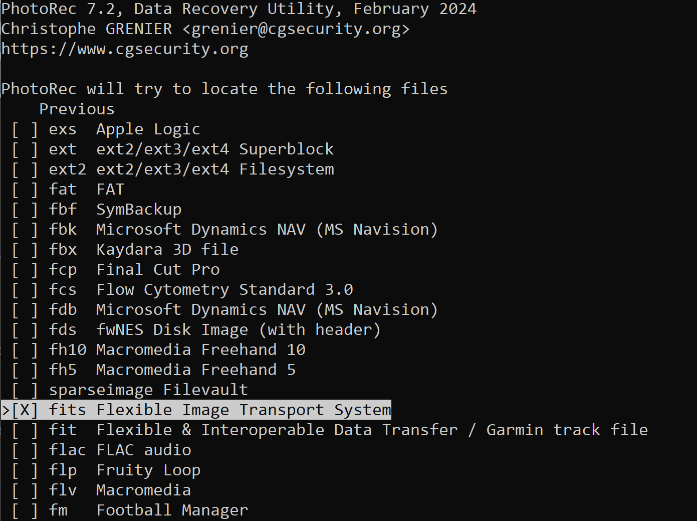

2. Photorec with default settings in terminal mode, ran the search on the partition. 0 files recovered
3. Photorec with default settings in terminal mode, ran the search on the drive. Multiple unrelated files recovered, mostly .exe, dll, txt, ttf and one .swf. All except for the swf have a size of at most 5,382 KB. The swf file is 2,458,789 KB
4. Photorec in terminal mode, made sure the sector size is set to 512B, and only the fit and fits files are enabled in the settings: 0 files recovered.
The paranoid setting is on but with brute-force disabled.
The recovery location is set to the external ssd where I also have the photorec executable.
What's strange to me is that there aren't any .fits file even though there should be hundreds of deleted .fits files on this drive.
I tried running photorec multiple times, I always select 512B as the sector size because I checked and the drive is formatted as NTFS with 512B sector size.
After it runs, I get a question: "Create an image_remaining.dd (254510 MB) file with the unknown data (Answer N if not sure) (Y/N) and I always select N

Re: Recover from SSD
yes, fits is supported. why the attitude though?
- Screenshot 2024-10-30 120759.png (98.69 KiB) Viewed 69801 times

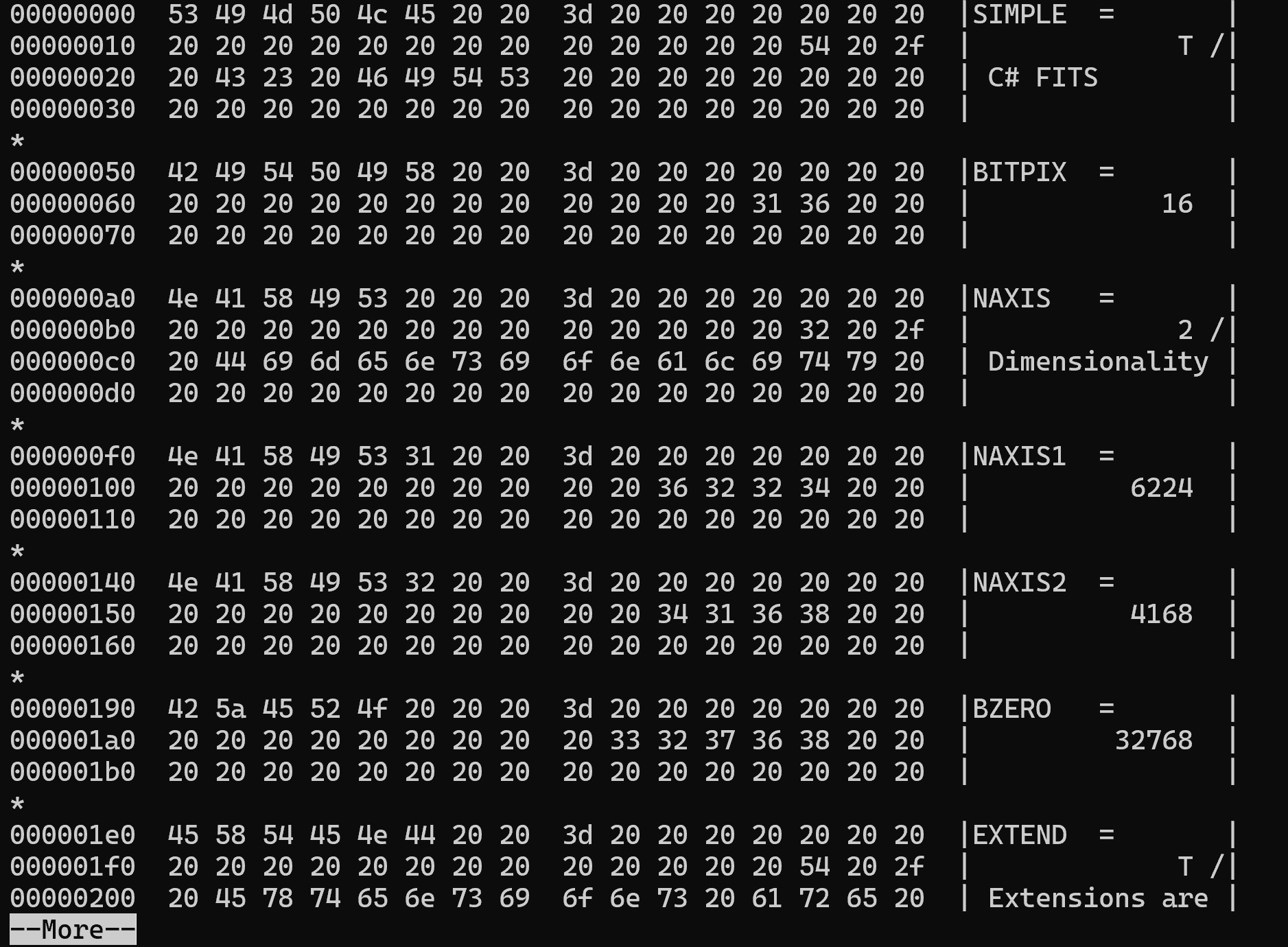

In the meantime I've looked a bit at the code. I'm not a C guy, mostly C# and just a bit of C++. However I found this:
at line 191 of
However, on fits files there can be either "XTENSION" or "SIMPLE" there, so it will break the loop even for valid fits files that have "SIMPLE" instead of "XTENSION".
Do you think including "SIMPLE" here could help or am I not understanding the code correctly?
I'm attaching the start of a valid fits file produced by the software that I use.
if(memcmp(&buffer[i], "XTENSION", 8)!=0)
break;
file_fits.cDo you think including "SIMPLE" here could help or am I not understanding the code correctly?

I a not a C programmer but I sometimes look into the code and look up the syntax of C simultaneously.
Your documentation suggests that PhotoRec will not recognize this variation of the FITS format.
You can add a user-defined fingerprint that fits to the "SIMPLE"-variation.
Please look into the manual and the online documentation.
Your next step is to verify that your fingerprint works correctly.
Take a storage device that does NOT support TRIM, partition it, format the partition and copy your sample on it.
Your sample should be located pretty much at the beginning of the device.
Delete your sample file on your test storage device.
Have Photorec examine the partition with the deleted sample file. A result should come up pretty fast without the need to traverse the whole storage device.
I don't have an opinion if patching/recompiling is a good way to go.
But keep in mind: Your file content is most likely trimmed away. Use a hex editor such as HxD to find the beginning of one file if you don't believe. HxD should fail as well.
The recipe given above should work, but not on modern TRIMable storage devices in combination with current operating systems.
I'll try with the fingerprint, thanks for the tip.
I understand that most likely the files are gone permanently due to TRIM, I'll report back my findings with the custom fingerprint.
[EDIT] Tried with the custom signature, nothing found.
In conclusion, recovery from SSDs is mostly not possible due to TRIM being enabled by default. It's probably the same on NVMe drives with DEALLOCATE and on SCSI devices with UNMAP.
Anyway, I guess I'm just very surprised that TRIM went to action in less than 10 minutes after I deleted the files. I thought it was gonna wait a while before moving data around on the drive.
The other intriguing fact to me is that random exe, dll and txt files were recovered - and those were probably deleted a very long while ago.
I haven't done a windows update on that laptop in ages. It's mostly not even connected to the internet because I want to avoid a windows update randomly happening when I'm out at night photographing.
