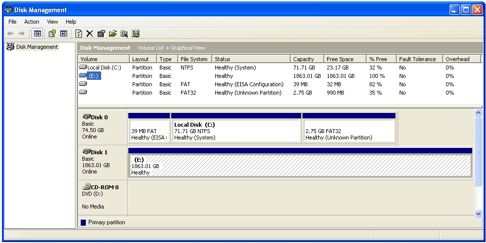

I have an external USB 2TB Seagate drive that suddenly showed as just the generic "Local Disk" instead of usual volume name in XP and no files or folders show on that drive in Windows XP - it just says the drive is unreadable or corrupt.
I booted my PC from a 10.10 Ubuntu Live CD and everything on the drive is showing fine, right down to the volume name. I've therefore been able to backup all required information off the unit under Ubuntu before attempting any kind of fix, just in case.
When viewing the drive back on the PC in XP's Disk Management it shows as "Disk 1" and "Healthy" but without NTFS, it's correct type, after the disk size. On right-clicking and checking it shows as "RAW".
As I know all the files are still there by using a non-Windows device (ie the Ubuntu disc) and also if I use Analyze in TestDisk then P to show files it sees every file/folder perfectly. TestDisk even sees the volume label where Windows doesn't and recognises it as a single partition. The Drive shows as "Primary Bootable" correctly and the only error I can see is that the 'Backup' boot sector shows as unreadable. The original boot sector shows as OK.

- Disk 1 ("E:") is the external drive in question.
- Seagate Drive Problem.jpg (242.65 KiB) Viewed 6837 times
