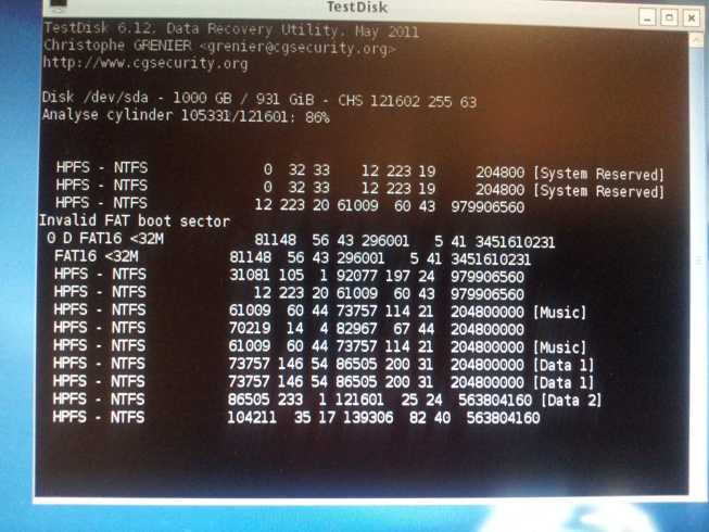

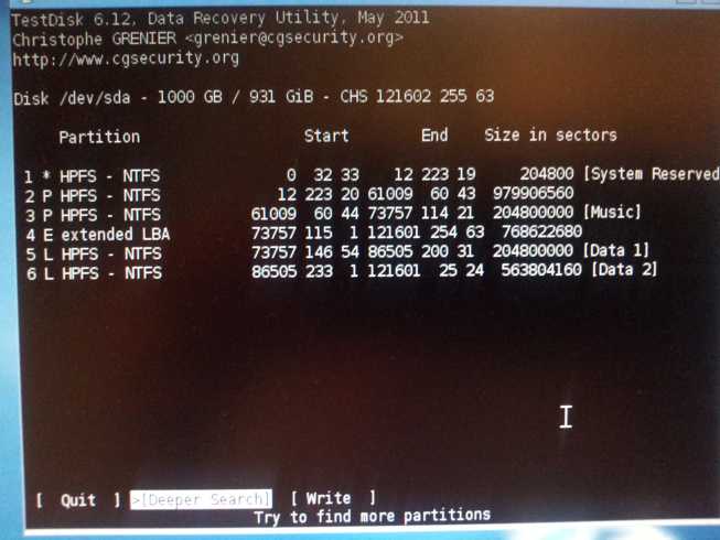

hi i am very much a novice please have patience! any help much apreciated. pc crashed with bsod, l am unable to access hdd internally or externally or run win 7 repair disc or chkdsk. after trawling the web i discovered ubcd and testdisk. i ran hdd health check - ok. i ran testdisk quick search all partitions seemed correct boot sectors ok but two partitions bad mft and bad mirror mft unable to repair. i decided to run deeper search and now i am very confused - i have attached some screen shots hoping some one can help me understand thanks in advance (there is one more attachment i cant add here which shows duplicate paririons after deper search)
- after deeper search
- Td4-1115735458.jpg (237 KiB) Viewed 8264 times
- after quick search
- Td21780969492.jpg (253.24 KiB) Viewed 8264 times
- quick search
- Td1-2143108610.jpg (227.07 KiB) Viewed 8264 times

Can you post
- the result of TestDisk, Analyse
- the list of your partitions with various information like filesystem type (FAT, NTFS...), the size, the label

Thanks for the reply - quick search3.jpg (after running quick analyse) is what I remember to be correct - all partitions NTFS - is this enough information?
deeper analyse2.jpg was taken just before deeper analysis completed - I never created any FAT16 partitions on the drive.
- deeper analyse2.jpg (70.37 KiB) Viewed 8226 times
- quick search3.jpg (56.97 KiB) Viewed 8226 times
