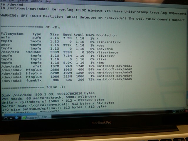

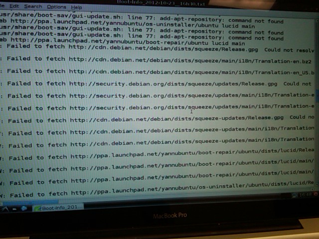

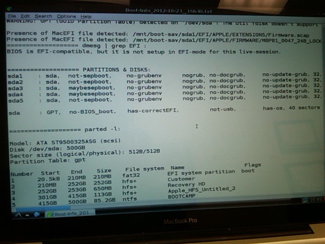

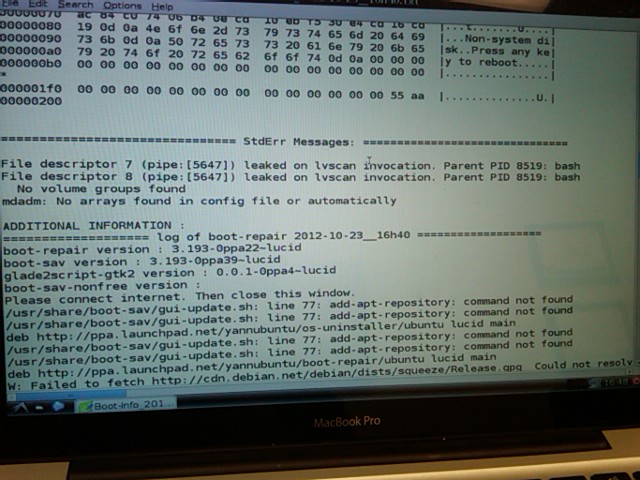

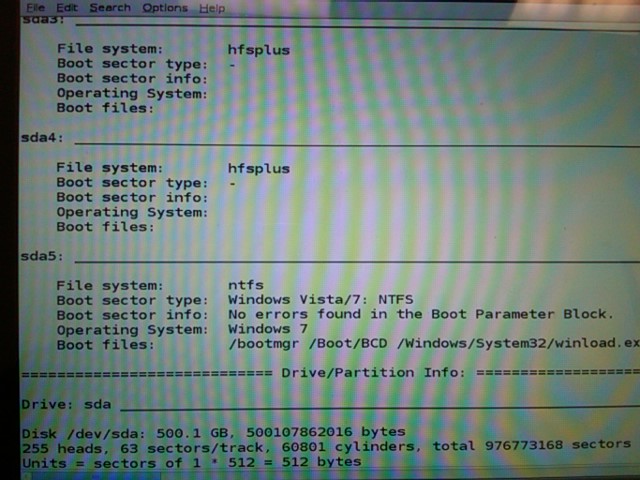

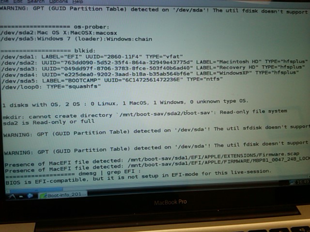

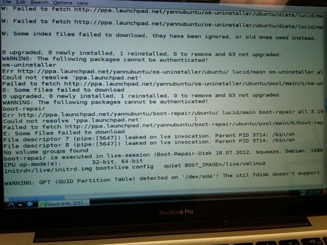

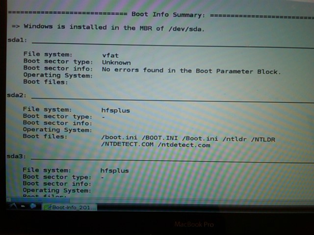

I actually Did find Boot_Disc_Repair that uses Debian Linux to try and diagnosis the drive problem. But it won't correct it because it found an EFI...which I believe is the firmware for the mac ox loading.
But I was able to take some pictures of the Boot_Disc_Repair and it has some really really good info about my disc. Still doesn't help me much as I'm not used to interpreting this stuff. But hopefully it will make some sense to you. All I know Is I think its all still there its just that its looking in the wrong place to boot or I messed up the MBR with gdisc but hopefully you can give me some more advice after viewing these screens...
And I'm looking into Steller
Heres the PICS

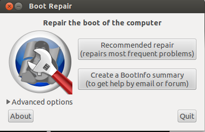

Boot repair allows you to paste the log into pastebin .. just as a URL.
See second button in screenshot below.
Saves adding all these images and you have a useful online record of your partitions.

Afterthoughts ..
Reading again .. this last line on your last screenshot image seems to offer some clue ..
dmesg | grep EFI
BIOS is EFI-compatible but it is not setup in EFI-mode for this live session
reading here ..
https://help.ubuntu.com/community/UEFI
https://help.ubuntu.com/community/UEFIBooting
as I understand a MacBook Pro is 64 bit architecture but can be booted up as 32 bit or 64 bit?
https://discussions.apple.com/thread/40 ... 0&tstart=0
Perhaps you need to use a 64 bit Live CD which is EFI-compatible ?
then install boot-repair from the Live CD session.
sudo apt-get install boot-repair
then just run boot-repair
Again I'm just guessing with MacBook Pro.
