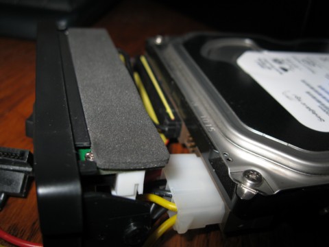

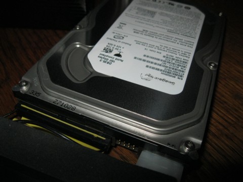

The pictures are from my own Dynamode USB connected IDE/SATA external adapter. Without the jumper it works.
With the jumper on it does not. In any case most IDE hardisks without a jumper on worked as Master .
The disk is a Seagate 160 GiB IDE. I use it to backup some downloads before committing them to DVDs.

- Picture of the same drive - Just to show you that there is no jumpers- It works!
- image_two.jpg (33.79 KiB) Viewed 4973 times
- Picture of a Seagate 160 GiB IDE -No jumpers - Works like a dream
- image_one.jpg (38.43 KiB) Viewed 4973 times
