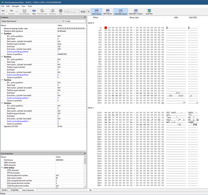

UPDATE: I opened in R-Studio's Hexeditor to scan visually. I think it is very likely the data was zeroed out somehow
. Can't imagine how, unless somehow trim does apply to unallocated space with no file sys, or there was some flash of current that just wiped it all when WSS tried what it did. I can see the little 128mb Windows Reserved partition in Sector 1:
Along with some bits in Sector 0 that might be a piece of the old partition table, or just the start of the 128 Windows Reserved one.

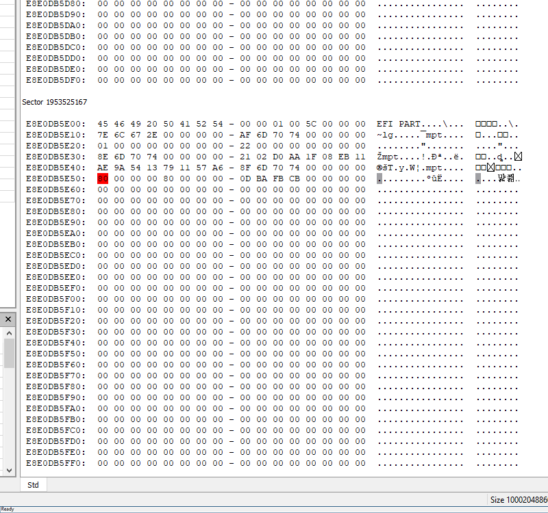

And in the very last sector I see what looks like another partition table, maybe for all love of god the old lost partition, but very possibly incomplete:

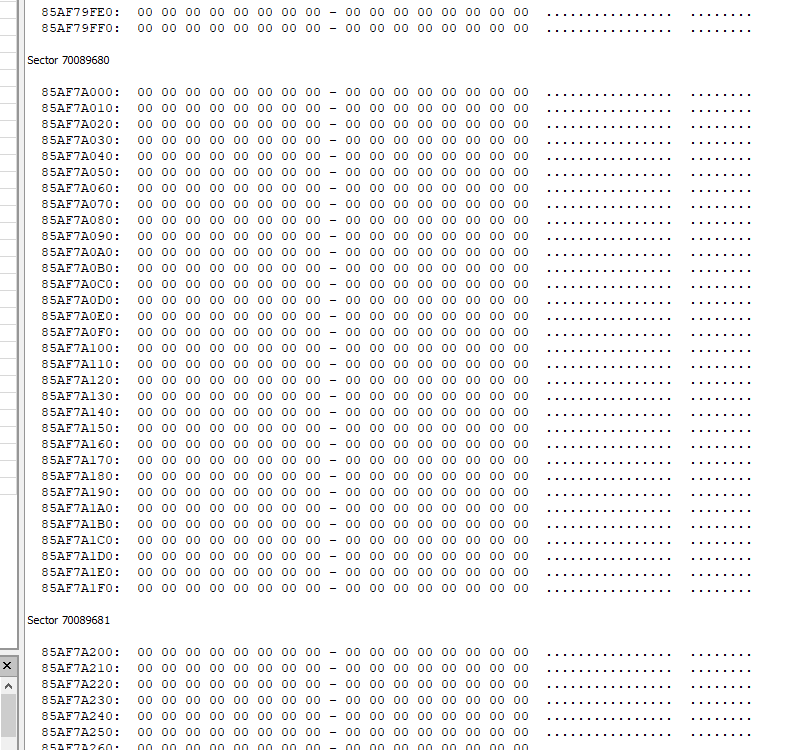

But regardless, every other sector between them seems to be flat 00 across the board, although maybe some were skipped too fast for an eye, it all scans solid this to me as I pull the scrollbar:
...Am I probably DOA? Could even deeper forensics get past these 00s? :'(
