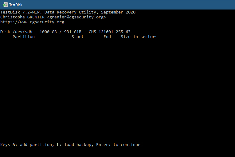

After "Analyse", this is what I get:
Do I have to re-add the correct partition myself from the recovery partition? What does "Load backup" mean, a whole disc backup from elsewhere, or backup info from the recovery partition?
Please let me know how to proceed here?

This is what I get when I hit "Load backup":
However I hesitate to do this bc I can't tell if that's the backup partition table of the old proper format, or if it's a backup of the new Unallocated space, for which "restoring" it would just mean restoring the current unallocated state, thereby overwriting the correct data I need and it really would be lost then.
Is it safe to go ahead and "Load" to see if it's the right one to confirm? I'm even more suspicious bc of the date/time shown for that "backup" partition.
Posts: 3196
Re: Recover UNALLOCATED Drives partially formatted by Windows Storage Spaces?
#5 Post by recuperation »
The backup you are talking about is a log file with partition table information generated on user demand.
Do not use this function.
Instead wait for Analyze to finish to see if you can see your exFAT-partition. If not, run deep search.
