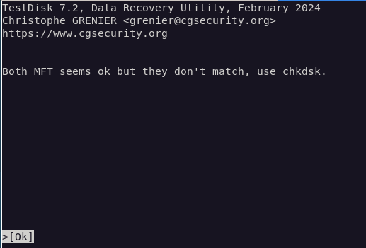

After running "Repair MFT" in TestDisk I received this message:

If you have cloned your disk using ddrescue as described in the manual, you can try out chkdsk.

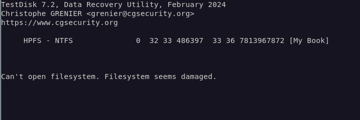

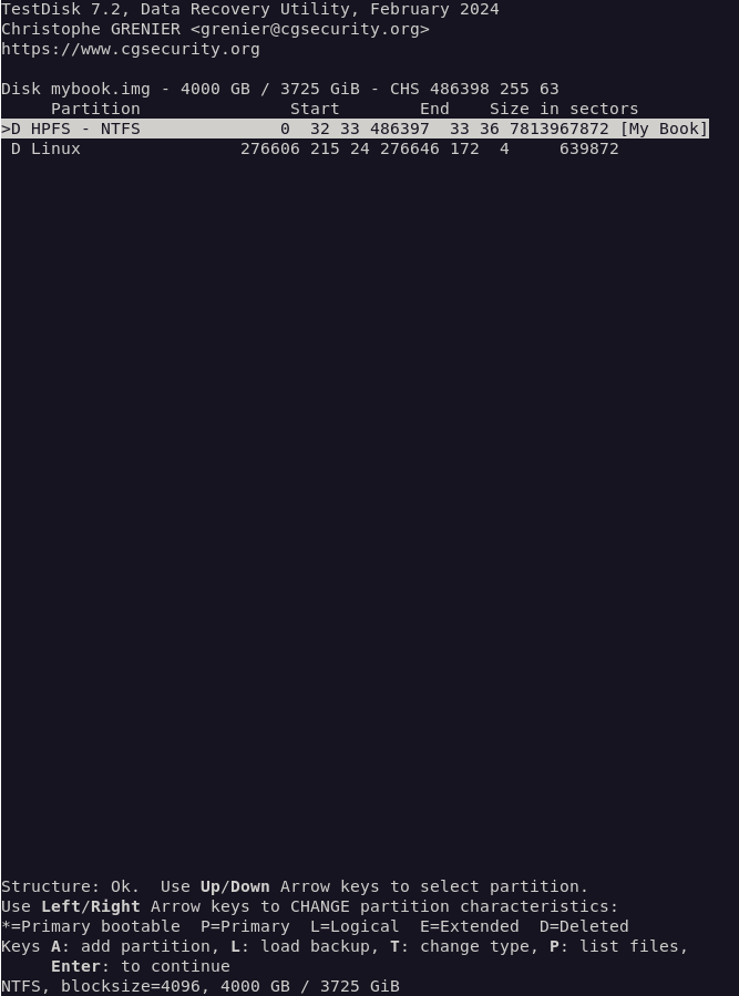

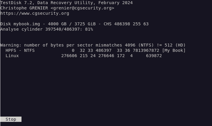

Also tried analyzing with TestDisk:
Next I will try to make a WinPE drive so try using chkdsk.

[102333.038992] FAT-fs (loop1): Can't find a valid FAT filesystem
Attempting ntfsfix:
$ sudo ntfsfix mybook.img
Mounting volume... NTFS signature is missing.
FAILED
Attempting to correct errors... NTFS signature is missing.
FAILED
Failed to startup volume: Invalid argument
Trying the alternate boot sector
Unrecoverable error
Volume is corrupt. You should run chkdsk.
Same mistake as above: You are trying to operate ntfsfix on a disk instead of a partition/volume.
I'm don't know if it would be worth deleting the current disk image which is of the whole disk and making another to work on that is just a clone of the partition. Maybe it would be easier to mount and work on.
You can keep the disk image by creating a virtual device pointing to the image.
Keep in mind that your "Mybook" has a sector size of 4096 if you keep it in hits enclosure. This is additional information regarding your clone file.
