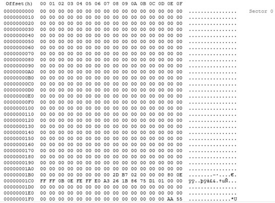

Hex Dump of SAGEM sector 0
Hope this helps.

It's very curious. Your first sector does have a signature, but it's 0xAA55 instead of 0x55AA.
It may be because your enclosure use inversion in byte order.
At 0x1Bh, there's a partition begin :
80 (bootable)
0EFFFF : begin of partition (old MBR before 32GB limit)
0B : FAT32
0EFFFF : end (like above)
E0A3261B : number of sector before partition (usaly read last-to-first : 0x1B26A3E0) but that make no sense there
8675D101 : size of the partition (usaly read last-to-first : 0x01D17586) but... no sense too.
It looks like your MBR was written with ytorder inversion (big-endian) instead of the way it should be (little-endian).
How to deal with that ? I don't know... Please provide the same hexadecimal dump inside the enclosure, to see if there's a difference...
I'll ask Christophe if he has an idea how to solve this.

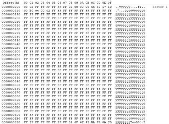

not sure what is meant by "inside the enclosure", so I'll give you sectors 1 to 256
SAGEM sector 1
SAGEM sector 1

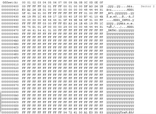

SAGEM sector 2
SAGEM sector 2
Sector 3 is filled with 0x01
So has sector 4, all the way to sector 255. Sector 256 has data.

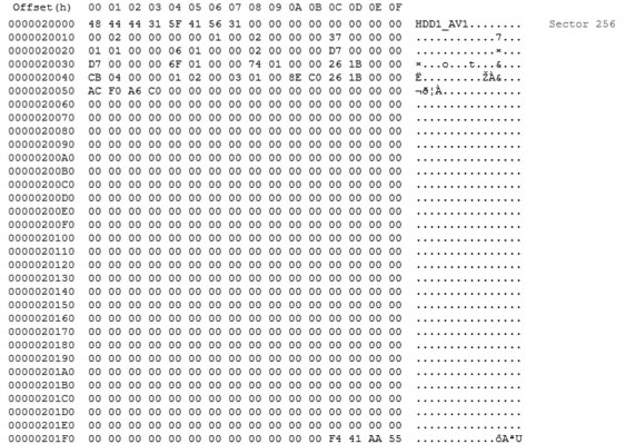

SAGEM sector 256
SAGEM sector 256

sector 256 also has a signature AA55 instead of 55AA.
I've asked to Christophe, who told me that you'll have to duplicate your disk with dd tool (under gnu/linux) using option conv=swab.
Do you have a linux working and/or some knowledge about it ? If you try alone, be really carrefull with dd to copy source on destination, and not destination over the source... :cry:
I'll help you, but that's just to know what kind of help you'll need.
