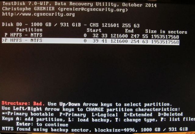

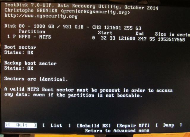

2. WD10EARS contains data
Testdisk advanced boot
bootsector and bootsector backup ok.
Both shown as D
i changed to P
First partition table shows files

Here are your instructions:
The partition table contains a single NTFS partition that match the disk size.
Run Testdisk, Advanced, select the NTFS partition, choose Boot, RebuildBS, List.
If you see your files, choose Write, confirm, Quit
