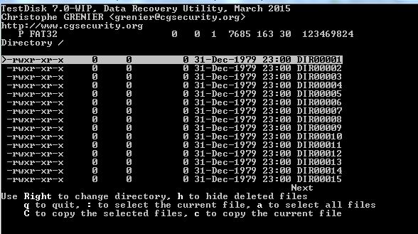

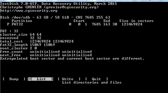

now I write 2 in the root cluster, I get a new screen:
after list I get the follow screen:
I can´t work with this files. (0,00 kb) that are not real directorys.

Please add a screen shot of your current partition table also.
It's TestDisk / Analyse and current partition structur (it's your current partition table).
