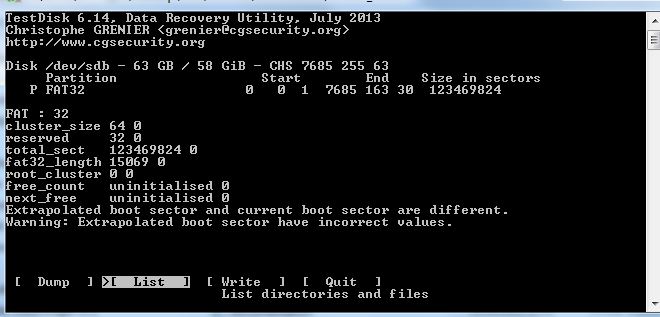

Then I test the same with Partition Table Type None (FAT32). You can see this on the next 3 pictures.
There I can Boot and Rebuild BS.After this, I get a list of files but if I press N(o), then the clustersearch break at 70%.
I delete the testdisk 64bit version and install the 32bit version. And now the same procedure with able Type None (FAT32).
It doesn´t stop at 70%, now I get 100% and I see more files. I think these are all file on my flash drive.
I press List at the end but I get the errormessage "No file found, filesystem may be damaged". (the last two pictures)
What should I do now?

what doe´s it mean in my two last screens?
root cluster: 0 (there is no root cluster)
flags: 0000 (???)
info-sector: 1 (???)
backup boot: 6 (???)

When using TestDisk, you can try to force the Root cluster to 2, it's the default values. You may have to enable the Expert mode in Options.

#10 Post by ddhh »
in which menu can I change the root cluster size?
