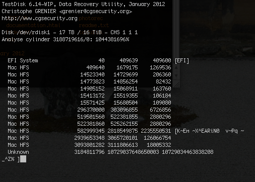

Just an FYI here is the session I just killed to run "fsck"
- Screen shot 2012-03-12 at 11.58.17 PM.png (188.16 KiB) Viewed 17661 times
