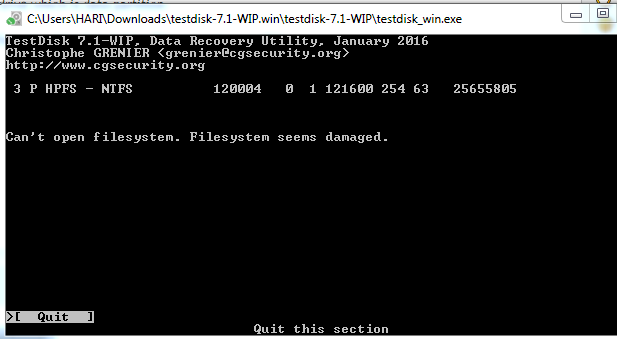

I am getting this on D drive which is data partition
cannot open file system File system seems damaged
laptop is booting and fine on c drive but d drive files are not accessible
kindly help
Filesystem Seems Damaged...How?

- Capture.PNG (20.23 KiB) Viewed 6906 times
Re: Filesystem Seems Damaged...How?
Try TestDisk, Advanced, select the partition, Boot, RebuildBS, List. If you can see your files, choose Write and confirm, Quit
