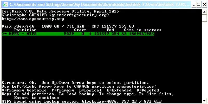

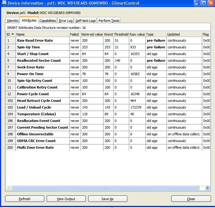

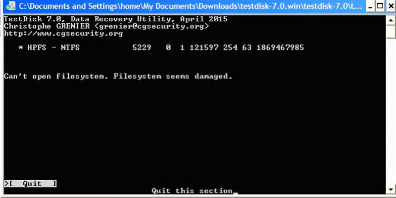

I'm new here. I just now read several threads on the repair of the filesystem with TestDisk and some instructions for doing so. I know little about this end of computers. With TestDisk stating only that the filesystem seems damaged, how does one know what steps to take? Could it be the MBR? Could it be the MFT? Or the filesystem in general? Without knowing these things, how will I know which step to take next? Sorry for being such a newbie.

Re: Filesystem Seems Damaged...How?
TestDisk displays a partition which starts before the middle of the disk space.
Is this the correct partition?
Can your run TestDisk / Deeper Search to have a try to find more partitions?
When more partitions are found, please select each partition and press p to have a try to list your data.

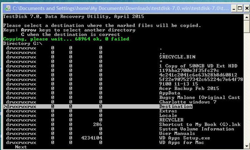

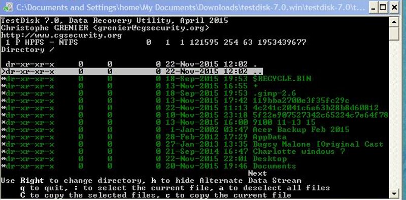

I am not familiar with partitions. I have never partitioned this drive. Unless it was partitioned when I bought it from WD, then it is not.
Since waiting to hear from you, I tried some things on my own. After having to rebuild the boot sector, I was able to list my files. Now I am in the process of copying my files to another ext HDD. First, I went to this other drive (G) and created a folder for the copied files. I named the folder 'Destination'.
I go back to TestDisk, find Directory G, and the folder 'Destination', and proceed to copy files. When I look in 'G', Destination folder, it is empty. Are these files copied in real time? Are they not showing up yet, because I'm copying the whole drive at once (428 GB). or have I done something wrong?
TestDisk copies files in real time.
Standard path will be the testdisk folder.
Can you check it.
To change directories, after selecting files for recovery, you can select these 2 dots in the upperr area of the display and press enter.
Each time you'll get 1 directory up until you get to your disk selection.
There, you can select another disk and partition as the destination.
You should avoid to select system files like Recycler and System Volume Information etc..
Can you check it.
The way you describe is the way I did it the first time, except that I directed it to Directory G and there was no folder or partition shown (at least, no partition as I remember), and the files did not show up in G. That's why I thought It might work better if a specific folder was the destination. I see I was wrong. I will try your way again and get a screen shot for you.
Funny, every time I try again, I have to rebuild the boot sector each time.
My problem now, is that when I select the two dots and press enter, after selecting files to be copied, nothing happens.
- sc9.JPG (84.63 KiB) Viewed 15968 times
Fiona,
I have made a mistake. I thought when I opened 'G', I should see my copied files, there. I did not realize til just now, that TestDisk had created a separate 'page' within 'G', and placed my copied files there. All are not there because I had aborted the operation before it had finished. Now, I am copying one directory at a time for the rest of them and all seems to be going well.
Another question for you, please. I know for a fact that all the data on this donor drive is intact. It was not accidentally formatted. None of the files were accidentally erased.
I think the reason I got the request to format in the first place was that maybe I did not
'Safely Remove Hardware' the last time I disconnected the drive from the computer. If I did forget to, maybe it affected it's USB chipset?
Anyway, now that I know all the data is safe and intact on the donor drive, is there anything I can do with TestDisk to 'repair' the drive so that when I try to open it from Computer, I can, rather than still getting a request to format. If that is not possible, I will format the drive after copying the rest of my files to 'G'
I do appreciate all your help
Thank you so much
Doug
