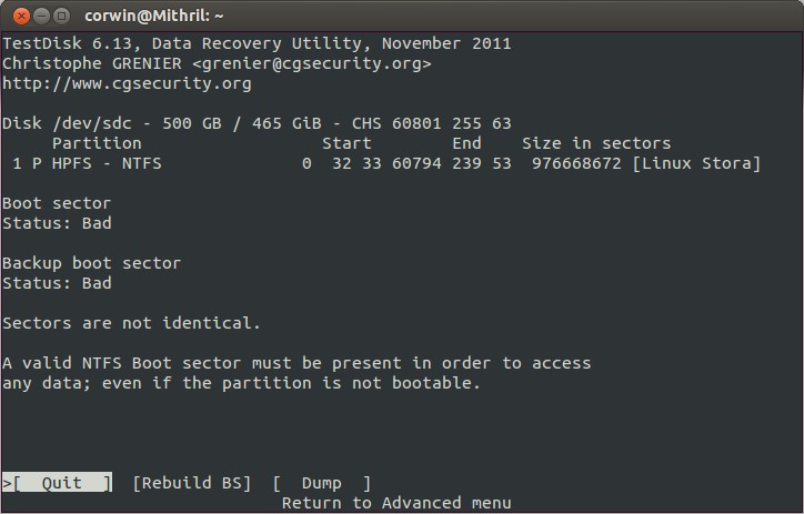

Re: This partition could not be recovered, size does etc
picture included of what it showed, trying to build it now.

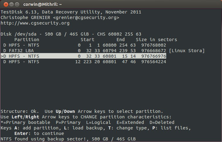

ive noticed in this screenshot that two ntfs are being found in the backup sector, are these likely it? and how to restore these?
