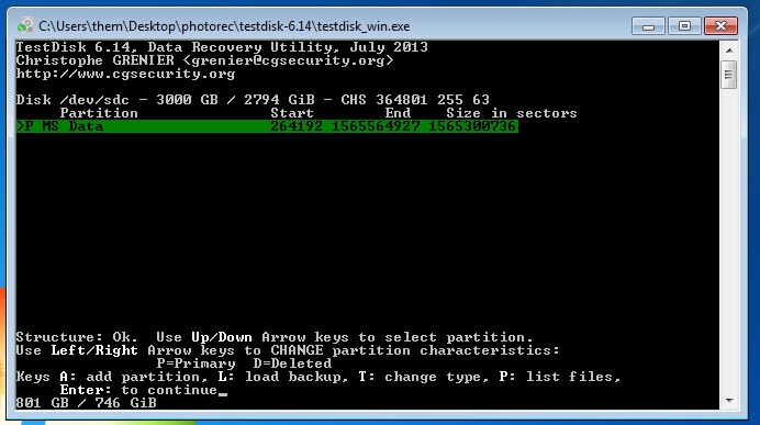

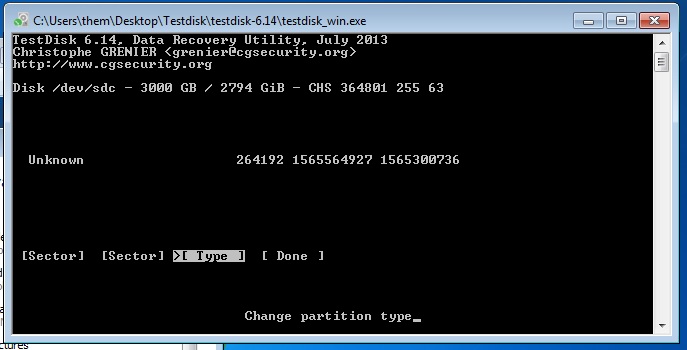

Ok, so after checking manual values entered again, (knowing them to be wrong) doing MS DATA > NTFS , on the next page where you select P to list files, at the bottom under "Enter: to continue__" it's showing "801GB/746 GiB"
which is the size the drive showed up as the first time I'd tried to use Testdisk after the 2.2tb motherboard/windows failure had it showing up as a Raw drive. Once I'd updated the driver to Intel RST, Testdisk showed the drive as 3000GB/2794GiB
TD_801 746.jpg (74.27 KiB) Viewed 7230 times

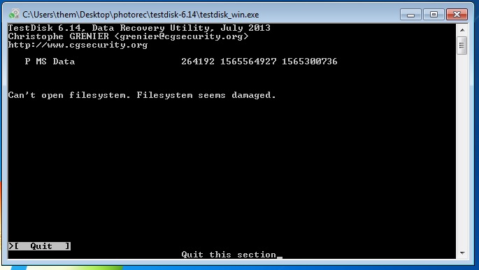

after pressing P, I get this:
As you can see, the end values are not what I had input initially before pressing enter, and it seems the same occurred for ostrichsak...

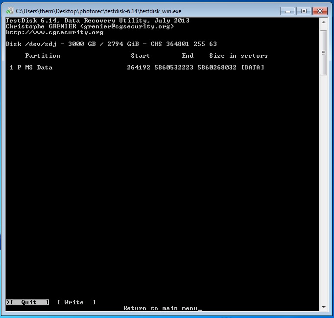

So perhaps there's some error occuring when manually entering. These are the numbers I got right after the deep scan when I was afraid to write (as I wasn't working on a clone of my bad drive but the bad drive itself):
EDIT: AS I'M TRYING THE DIFFERENT OPTIONS, I FIND THAT I ONLY GET THESE WRONG NUMBERS WHEN I STOP THE ANALYSE PHASE. IF IN THE BEGINNING, I CHOOSE THE DRIVE > EFI/GPT > ADVANCED >
I get this: See next post. limit of 3 atachments

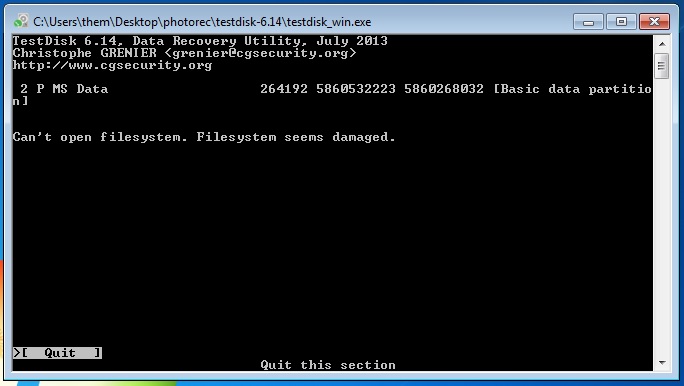

from ADVANCED:
msdata > ntfs gets me these numbers (same as after deep search without my drive name of DATA [i'd named the drive this when first setting up the drives. confusing now I know])
with unfortunately the same result:
Unfortunately, I never took a screen shot of what files were listed after doing the deep search. I don't recall getting this error message, I thought it just showed a size of the data, but I could be wrong. There certainly wasn't any long list of files though. I suppose I could wait another 4 days for a deeper search to complete again. But right now I would really rather get onto cloning this bad drive so I have no fear of clicking on "write" at any time. As of now I fear to.

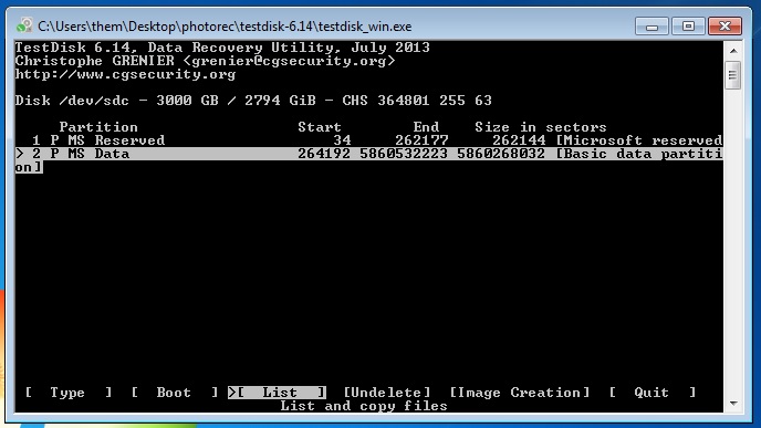

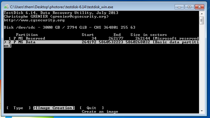

I went into Testdisk > advanced > chose the partition with the correct start and end numbers of 264192 5860532223, and this is where memory gets a little muddy, I might have tried to list files and got the "can't open file system, file system seems damaged" warning. at this point I think I chose "write" then got the BS as bad, and Backup BS as good, but because I didn't go back and read the instructions chose "rebuild BS" instead of "backup BS" which might have been my second screwup after chosing the advanced path rather than the "quick search > stop>" process.
after this when listing the partition, 3 showed up instead of two. Presumable two BS's and the other was again my ms data partition of 5.8gb (not corresponding to the data I originally had on the drive) on which I could not read the files.
Sooo, I quit Testdisk (by the way, I've not yet been able to locate the logfile which I did chose to create this time), rebooted (as TD had said I'd have to for the rebuilt BS to take effect). CHKDSK attempted to start, I stopped it, got into windows and the drive showed at D: (but was unlabelled) and I got the following error in attempting to access it:

I got into testdisk, did the standard steps to get to the analyse page (chose the 3000gb drive > gpt > analyse etc), started the quick search, stopped it, chose A to enter partition manually, and entered the start and end numbers of:
264192 and 5860532223, but once again upon pressing enter when the numbers have been input, they show up incorrectly with the incorrect drive size of 801GB/746GiB at the very bottom, and then upon listing files, get the "file system seems broken" warning.
After this page, the files do not get listed. So I'm thinking that in order to have the correct numbers in here do I have to actually let the quick search and the deep search run???? That will be another 4 - 6 days like it was last time....

Please cgrenier or fiona, if you have any idea as to why I'm getting the wrong numbers when I enter the correct ones, can you fill me in?
