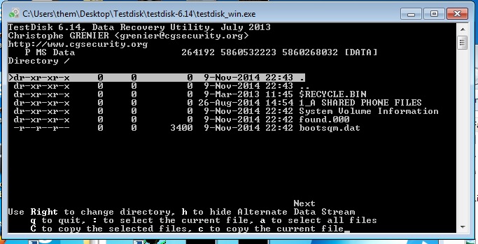

PS oh I went back into testdisk after doing the CHKDSK and doing QUICK SEARCH > STOP > PRIMARY > LIST FILES at this point when listing the files, 7 show up, all but one apparently empty.
post chkdsk files.jpg (91.8 KiB) Viewed 7185 times
