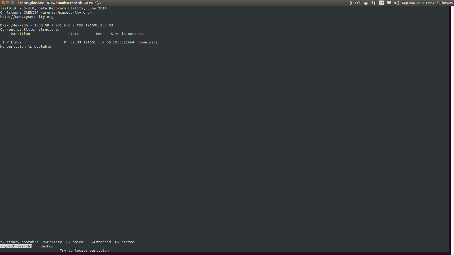

Sorry i didn't noticed that so far i was using 64bit version.
I downloaded 32bit and the results are these:
Also here is the output of testdisk 32bit
Sun Jun 22 01:12:54 2014
TestDisk 7.0-WIP, Data Recovery Utility, June 2014
OS: Linux, kernel 3.13.0-30-generic (#54-Ubuntu SMP Mon Jun 9 22:45:01 UTC 2014) x86_64
Compiler: GCC 4.4
Compilation date: 2014-06-21T09:16:18
ext2fs lib: 1.42.8, ntfs lib: libntfs-3g, reiserfs lib: 0.3.1-rc8, ewf lib: 20120504
User is not root!
Disk /dev/sda - 400 GB / 372 GiB - CHS 48641 255 63, sector size=512 - WDC WD4000AAKS-00TMA0, S/N:WD-WCAPW1513407, FW:12.01C01
Disk /dev/sdb - 1000 GB / 931 GiB - CHS 121601 255 63, sector size=512 - WDC WD10EZEX-00ZF5A0, S/N:WD-WMC1S2520330, FW:80.00A80
Disk /dev/sdb - 1000 GB / 931 GiB - WDC WD10EZEX-00ZF5A0
 1 P Linux                    0  32 33 121601  57 56 1953521664 [Downloads]
recover_EXT2: s_block_group_nr=0/7452, s_mnt_count=1/4294967295, s_blocks_per_group=32768, s_inodes_per_group=8192
recover_EXT2: s_blocks_count 244190638
recover_EXT2: part_size 1953525104
     Linux                    0   1  1 121601  80 62 1953525104
     ext4 blocksize=4096 Large file Sparse superblock, 1000 GB / 931 GiB

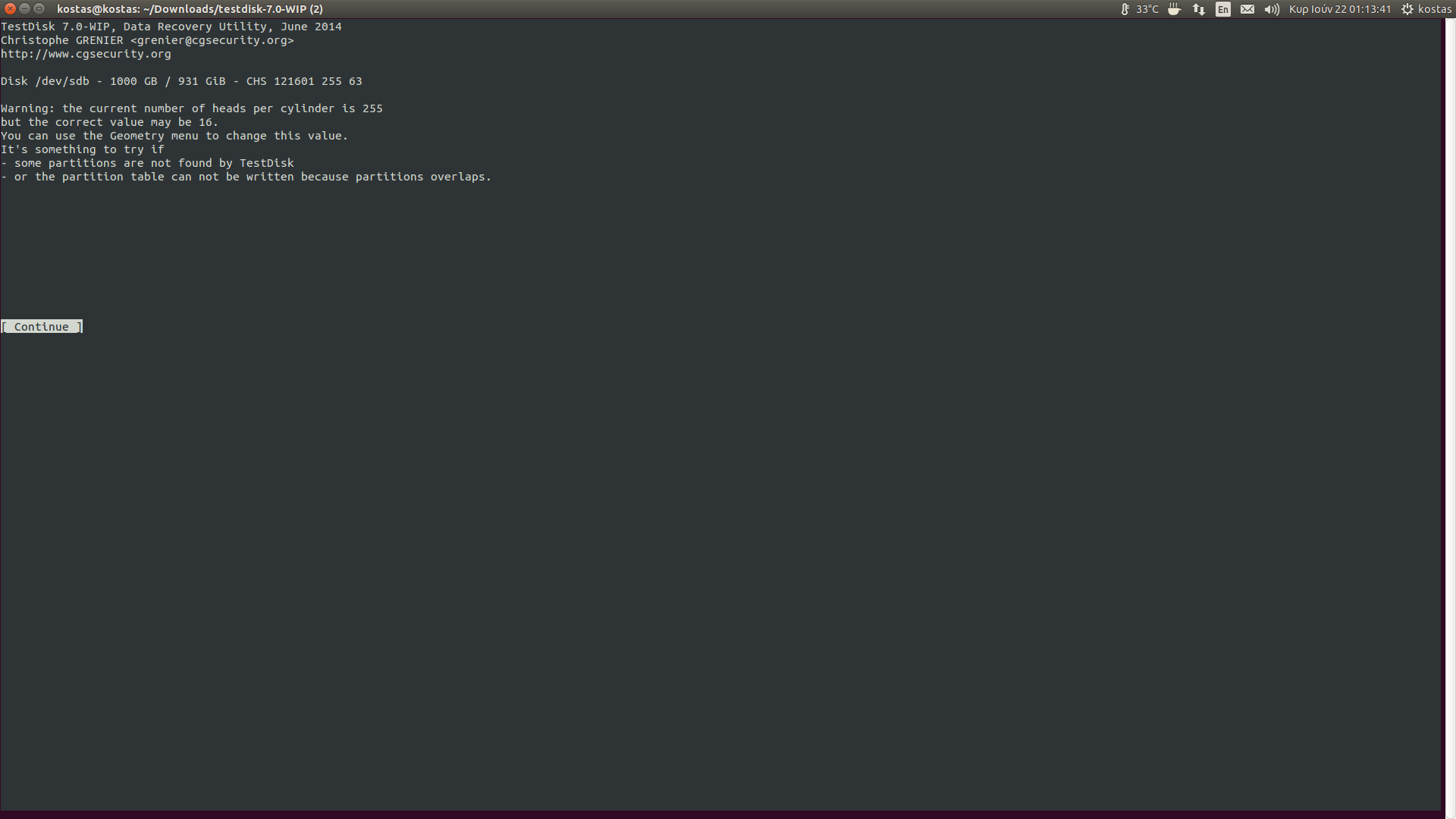

Warning: the current number of heads per cylinder is 255 but the correct value may be 16.
   * Linux                    0   1  1 121601 254 63 1953536067
dir_partition inode=2
ext2fs_dir_iterate failed with error 2133571402.
 1 * Linux                    0   1  1 121601 254 63 1953536067
Is there anything wrong or i can continue to use the disk?
Re: Unable to recover partition
Posted: 22 Jun 2014, 06:57
Especially to advanced format, in my tests, even windows explorer was generating sometimes messages, like repair, sometimes testdisk found a partition and sometimes not.
Windows explorer also.
Advanced format is a different alignment and was especially used under winxp because of degraded performance.
Even 4k sectors are handled different.
They emulate 512bytes sectors, otherwise the disk might be not bootable.
Info about OS support:
http://support.microsoft.com/kb/2510009/en-us
Actually testdisk supports 4k sectors.
For me it looks like that advanced format still stucks somehow in the infancys?
Especially abou disk geometry.
Since vista, microsoft aligns partitions not on cylinder- but megabyte boundary.
TestDisk supports megabyte boundary but testdisk is generally based on PC/Intel-MBR.
If a partition is not PC/Intel-MBR standard, testdisk displays a message that geometry might be not correct.
Can be ignored.
Microsoft alignment on megabyte boundary is recognized if a partition starts after 1 MB at cylinder 0 and head 32 etc..
You can watch it on your photo and current partition strucure.
Some info about PC/Intel standard:
http://www.cgsecurity.org/wiki/Partitio ... nd_logical
In this case, everything is normal and there is no further action required

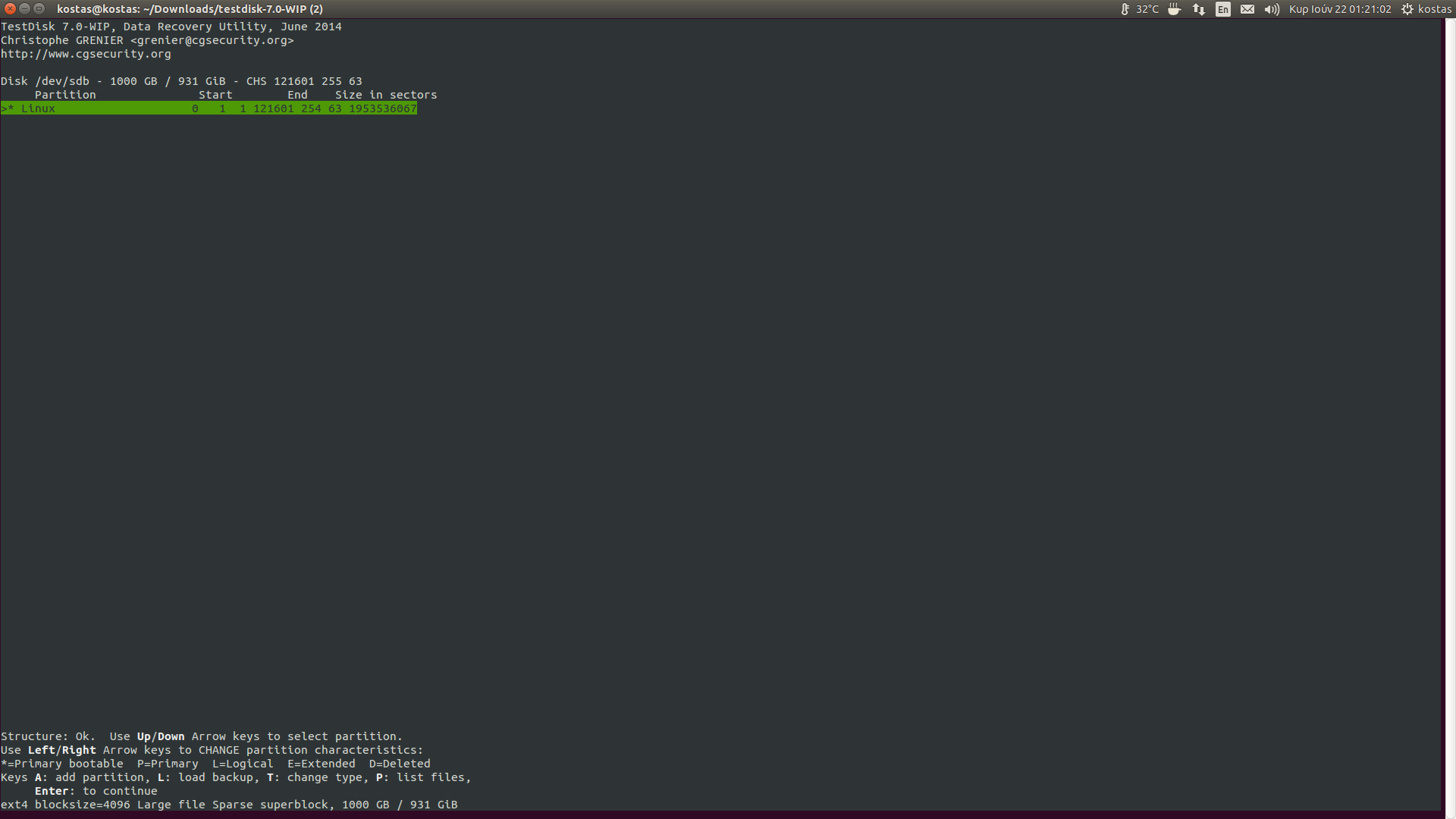

Posted: 22 Jun 2014, 18:17
by anapodos
Yes i deleted the partition and created a new one.
This is what TestDisk shows. Is it right now?
Posted: 22 Jun 2014, 20:05
Yes, your partition starts with the right values.
