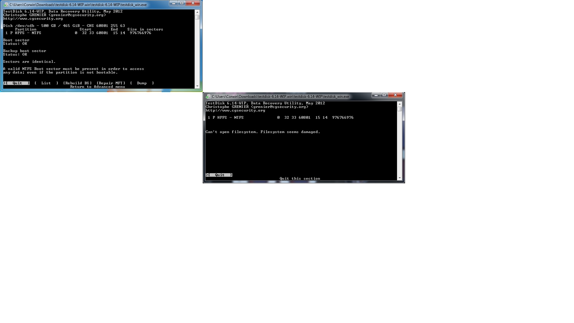

Re: This partition could not be recovered, size does etc
Couldn't list the files again (see attached)
so does that look bad then or?
