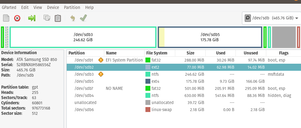

OK, after deeper search, I identified the ext4 partition I want to recover. It stills has the files I need.
The problem is deepter search shows some MS partitions as deleted (while analysis didn't) and it "founds" a good number of partitions that don't exist resulting in overlapping and broken partition table.
Here's the log : https://drive.google.com/file/d/1EMjLsF ... sp=sharing
Is there a way to tell testdisk to stop searching and simply undelete a partition starting at 888'901'632 and being 83'302'392 long, and load the previous partition table to write all this up?
EDIT: Would it be safe to add it directly into the backup.log to load?

Gparted:
Screenshot from 2020-04-30 13-40-26.png (74.5 KiB) Viewed 1793 times

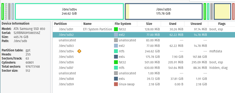

EDIT2: Looks like it's possible but it splits some partitions in 2 and find overlapping partitions:

After re-entering types from gparted, I get a working structure (not applied yet, waiting for your reply):
     Partition               Start        End    Size in sectors
 P EFI System                  2048     264191     262144 [EFI System Partition] [NO NAME]
 D Unknown                     2048     591871     589824
 P EFI System                264192     421887     157696
 D MS Data                   421888  888573944  888152057
 P Linux filesys. data       591872     749567     157696
 P MS Data                   749568  517943295  517193728
 P Linux filesys. data    517943296  886583294  368639999
 P EFI System             886583296  887609343    1026048
 P Windows Recovery Env   887609344  888899583    1290240
 P Linux filesys. data    888901632  972204023   83302392
 P Linux Swap             972204032  976773103    4569072
>D Unknown                972204032  976773117    4569086
I guess I'll use gparted for the flags?
If I messed up with exact format, can I change it back afterwards?

I applied and now I get some weird partitions:
Screenshot from 2020-04-30 14-40-43.png (68.84 KiB) Viewed 1775 times
I'll try to boot though.
How could I get back the previous partition table for boot?
