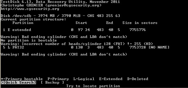

Your partition in your partition table is different to the found one using Quick and Deeper Search.
Please test a boot sector diagnose (Rebuild BS) on that wrohn extended partition in your partition table.
Extended partitions don't contain any data, that's why you should change it to FAT32 LBA.
Please do the following diagnose;

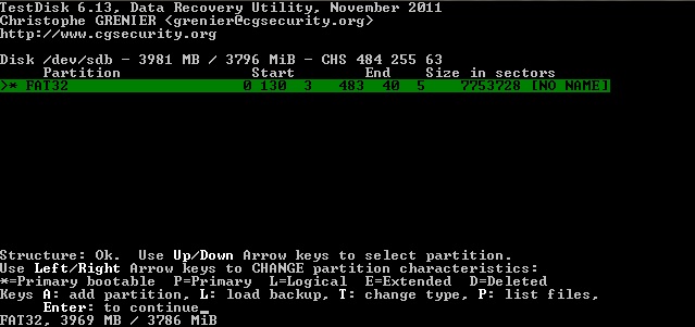

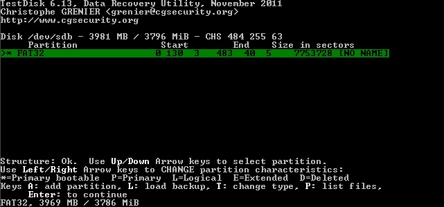

Now you probably see only your extended partition.
Please check the menu "Type" and press enter.
Press enter to continue.
At the right, your cursor will be blinking.
Type 0c for FAT32 LBA.
Press ok to leave the menu.
Confirm at Boot.
Infos will follow.

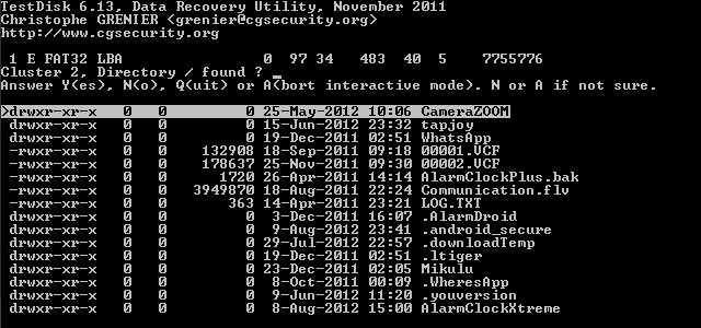

I can see my folder but not sure what to do next now..
- After rebuilding
- rebuildbs.jpg (81.3 KiB) Viewed 18770 times

Easily confirm with y for yes to keep these folders and files.
TestDisk can still look for another directories.
If you see any, conform with N.
If Rebuild is finished, you see a menu List.
Please check it and confirm with enter.
Now it's time to copy your data first.
At the bottom of the screen are all the commands.
Standard directory is your testdisk folder.
If you want to change ist, you can mark that two dots and press enter, you'll get one directory up.
To enter any folder, just check it and use your right arrow key on your keyboard.
Standard path where you copy your files to is the testdisk folder.
Olease let me know.
If you get displayed more directories with files and in your current directory are some files missing, you can repeat this diagnose for the next directory.
Until you don't use Write, you'll not going to change anything to your SD card.

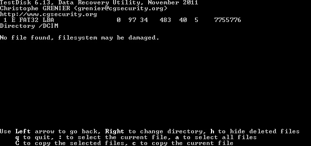

This used to be my camera photos and videos. Can't seem to find them anymore in here and I cannot open it using computer. "File or directory is corrupted and unreadable".
- DCIM is where camera photos are
- missing items.jpg (37.44 KiB) Viewed 18767 times

Can you recover your photos and videos first using PhotoRec in your testdisk folder?
Some Infos;
PhotoRec doesn't keep the file names nor directories but would be ok for photos.
Please have a try to recover it first, so that you have at least some files back.
Afterwards you cann still try to repair it using TestDisk or at least to copy data.

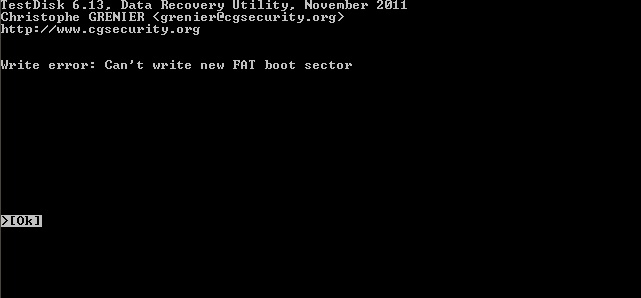

After I recovered my things, I rebuild BS and now they show the corrupted folders deleted. I don't mind, but I cannot write it. When I check my card it shows those files deleted but somehow the memory space used by those files remain.
- This error shows up
- cannot write.jpg (19.01 KiB) Viewed 18738 times

Do you have any background process like Antivirus, Norton GoBack, Norton Sonar, which prevent testdisk from writing a boot sector?
Also check the status of your card using CrystalDiskInfo.
If you have as far your data, you can consider to reformat it for further use.
Best way to have it compatible would be by using your camera.
Otherwise you can try the HP USB Storage Tool.
Might be possible that your card is physically damaged.
In case you should replace it.
