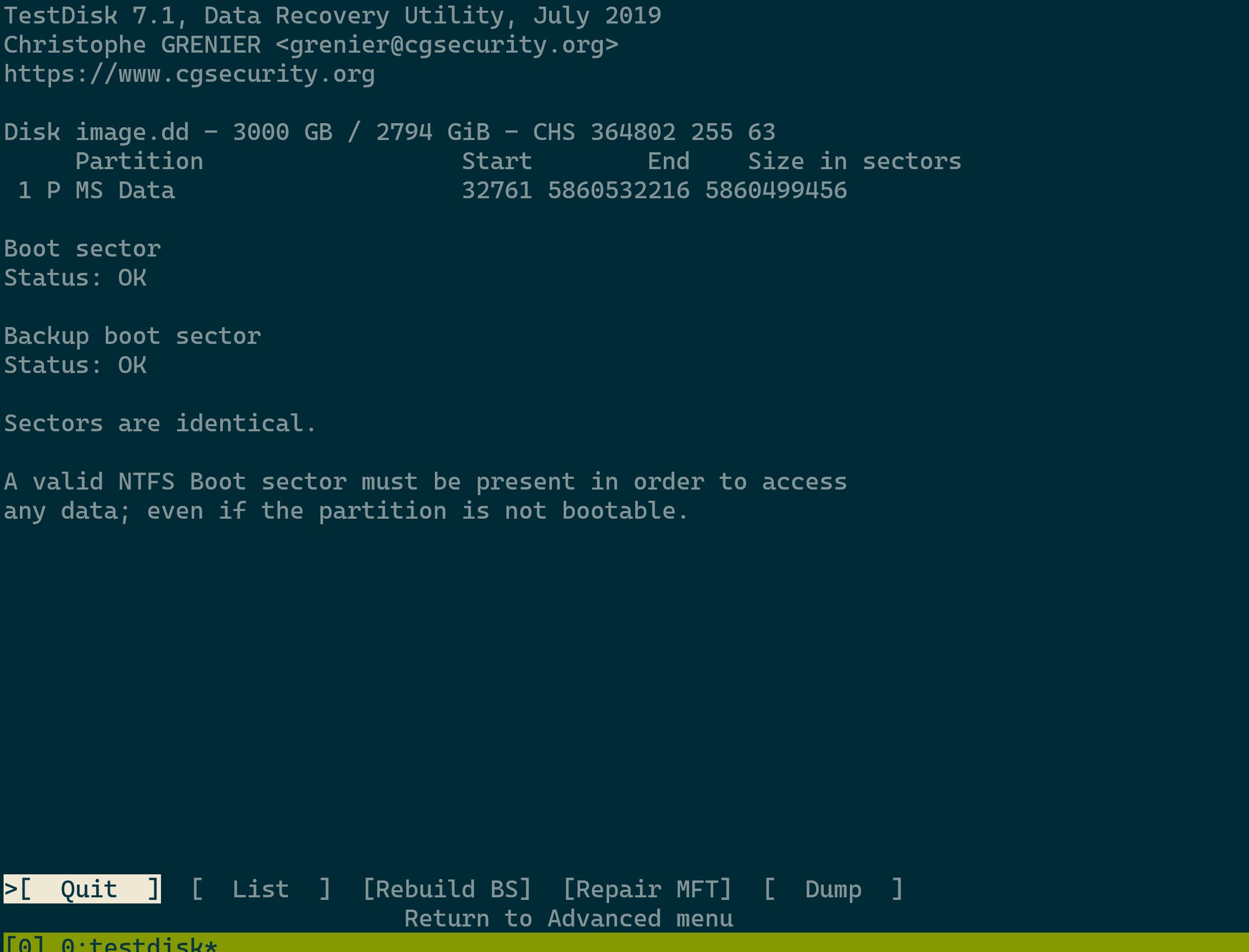

I seem to be going round in circles a little bit. I ran testdisk on /dev/sdb which created the file image.dd which was an identical size to /dev/sdb. I then ran testdisk on ./image.dd which started the image preparation process again, as if it was going to make an image of image.dd
I was also thinking: surely to get at the data (which as I've said, must still be there), it needs first to be visible by entering in the encryption password for the luks-dmcrypt layer. That reveals /dev/mapper/DISK which has not been touched since the creation of the original luks header and is the layer where the NTFS data should be found. So I run cryptsetup luksOpen /dev/sdb DISK to map to /dev/mapper/DISK. If I run testdisk on /dev/sdb with decrypting first, surely there is nothing to see as it presents itself to testdisk as a luks encrypted disk.
So back to basics. The NTFS disk had the following command performed on it: cryptsetup luksFormat /dev/sdb DISK and an initial password was entered. /dev/mapper/DISK appeared for the first time but I did not format it as one would if one was looking to create a usable encrypted disk. I just closed the mapper. If the NTFS data is on the /dev/mapper/DISK layer, how can I use testdisk to get at it? Presumably it terms of what has to be done, the NTFS data (aka partition from the previous FS) has to be found and a new GPT label needs writing. FYI, there is only one NTFS partition (all of which I need) and it's the size of the whole disk (2.7TB/3TIB). Assuming it's there as I think it is (if not I have a whole different problem), I just need a new GPT label and partition table right? How to do it though???

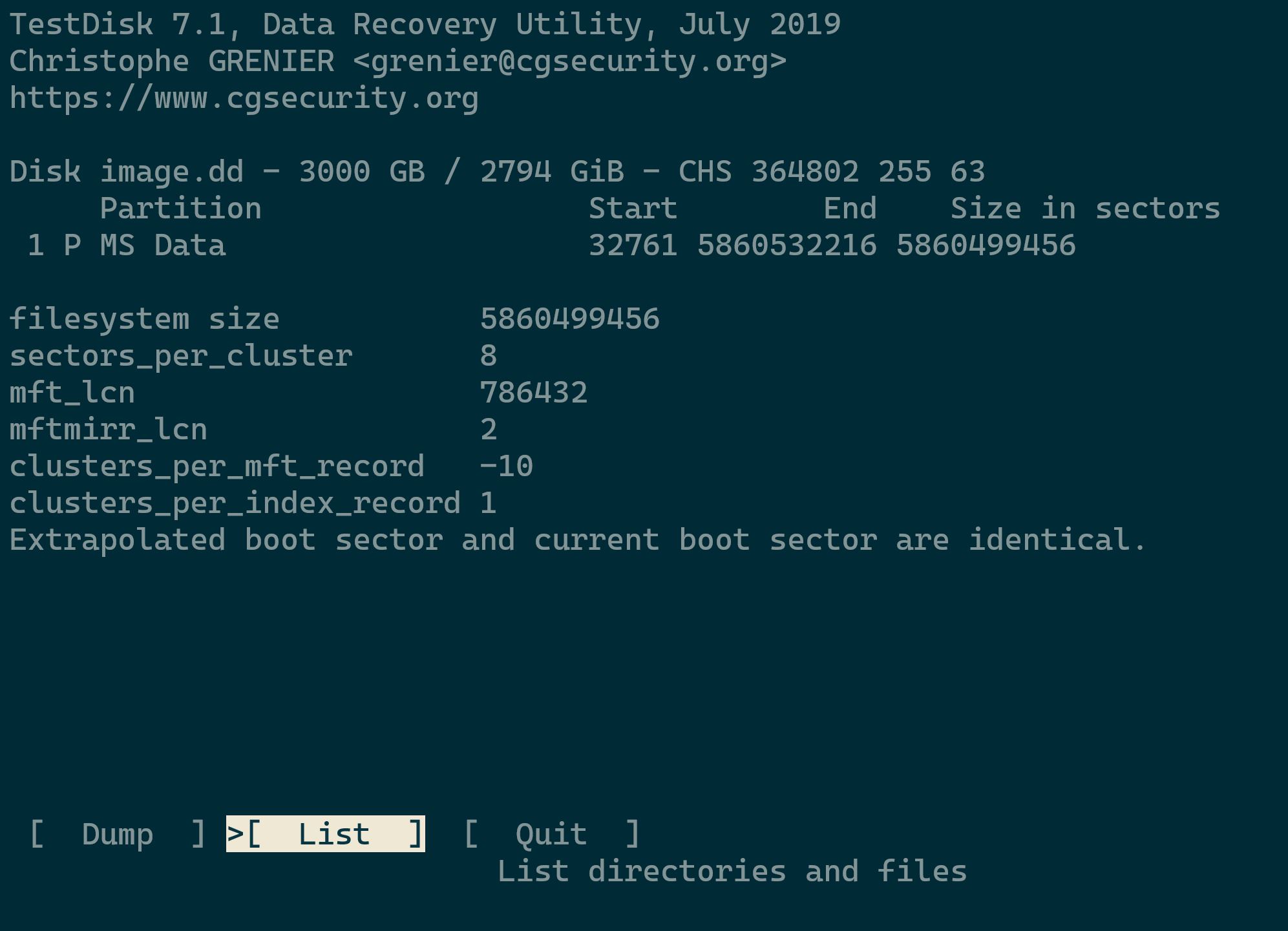

Hi everyone, I think I've made some progress but would appreciate any further advice. The attached captures which are named in sequence are the steps I've taken. Obviously the final one is the concern. I went back to the advanced menu and tried undelete which did not work.
Do I have any further options in order to proceed?
Note this post won't accept the final two screen grabs so I'll insert them into the next.
step1
step1
step2
step2
step3
step3

Final two screen grabs:
