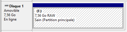

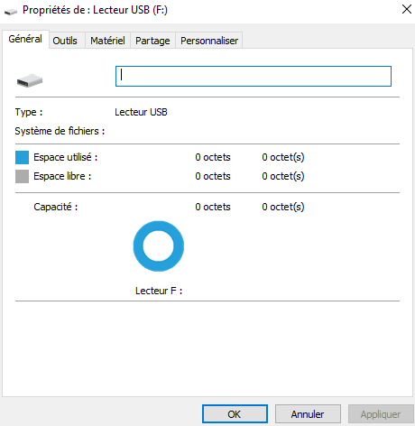

hello i have this sdcard i bought a while ago then it get broken and formating it didn't work so i ditched it
and here i am today want to fix it so:
it is sandisk sdcard with 8 GB i don't know even what's wrong with it, i tried testdisk it doesn't find any partition when i do analyse
it doesn't detect if it is intel partition or any thing and doesn't found any thing niether in quick search nor the deeper search
and it say "partition sector doesn't have the endmark 0xAA55"
help please

i did run the quick search and the deeper search and it found nothing i didn't capture them cause they were empty

Re: My Sdcard wont open or format
Try Photorec to see if it finds anything.
If that fails the SD card maybe broken.
You could try to duplicate the drive with ddrescue and check the ddrescue log file as well.
Afterwards you could try out write operations by trying to delete the whole card using the clean function of diskpart or overwriting using /dev/zero as source device in linux.
