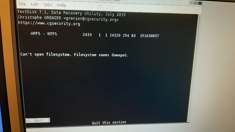

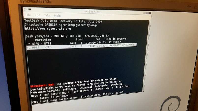

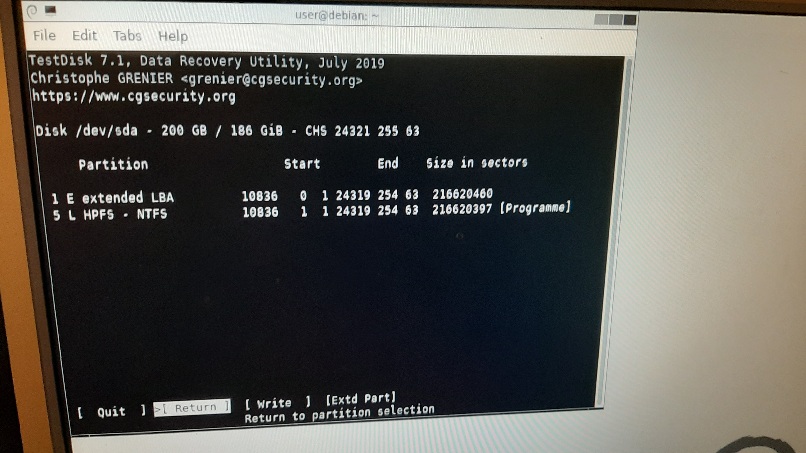

So I tried to recover the partition with a boot-CD and Testdisk. The problem is, it just founds my secondary Partition, not the important C:\ Partition. It founds another partition but it is corrupted. Laterly I will send some Images. There is no difference between the quick and the deep search.

Here are the pictures.

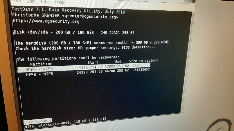

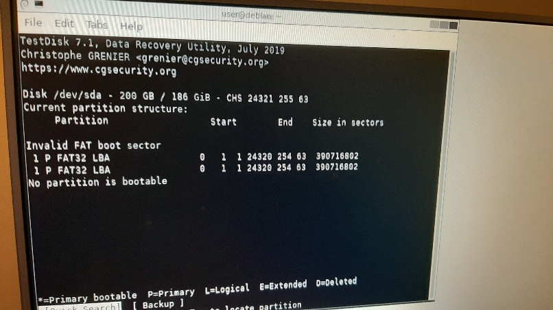

The rest

Did you get access to your lost partitions using the "p"-key ("list files") ?
If that fails, Testdisk won't be able to somehow repair your formated disk.
The question is what has been on your first partition - just some XP boot files? Those might be taken from another computer.
Does the "Programme"-partition contain your XP installation "Windows"-folder as well?

No testdisk could not find files in the first partition (picture 4), and there should be the whole windows installation. Normally i call this partition "windows", like "Programme" for the programs.recuperation wrote: 23 Sep 2020, 21:25 Did you get access to your lost partitions using the "p"-key ("list files") ?
