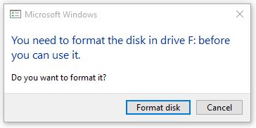

I have a 2 TB Western Digital (WD) HDD. It went RAW. The drive is detected by my machine but when I try to access the data by double clicking on the drive, it gives the following error:
"You need to format the drive F: before you use it.
Do you want to format it?"

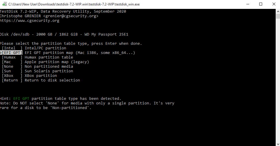

Hello
Thanks for the response.

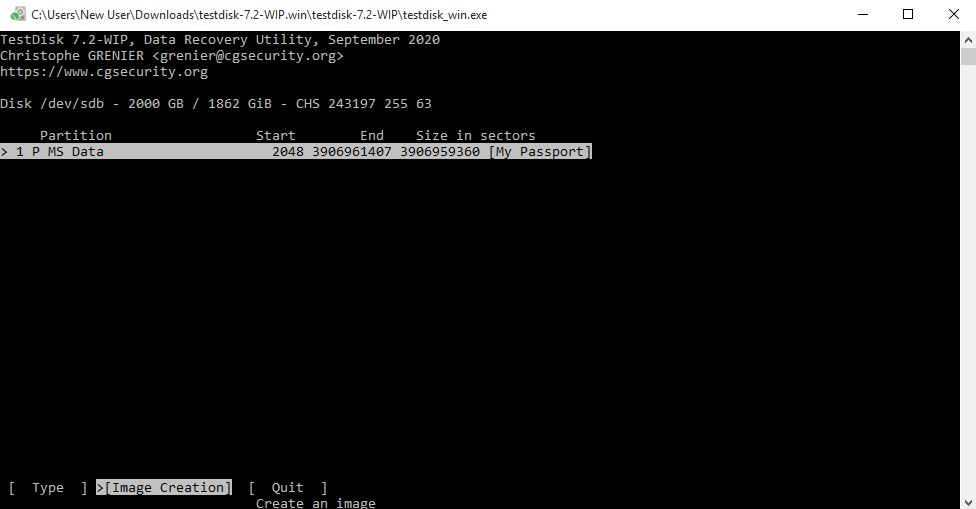

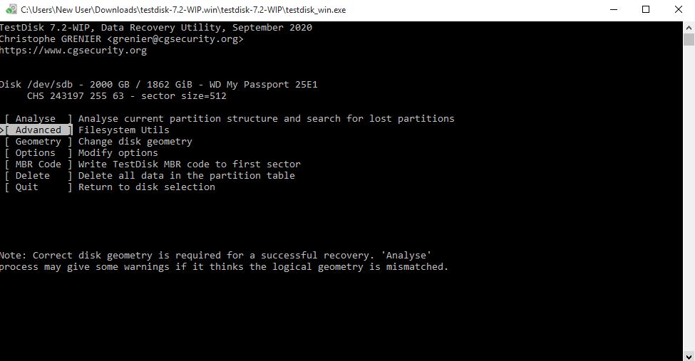

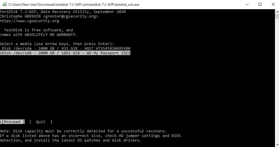

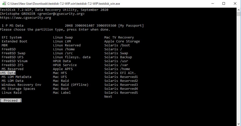

The HDD has only a single partition. Attaching the screenshots for your reference. Kindly advise.
Thanking You!
Re: WD HDD 2 TB turned RAW, asking to format, data not accessible
Posted: 27 Oct 2020, 19:32
by rumikodia
Attaching more screenshots:
Thanking You!

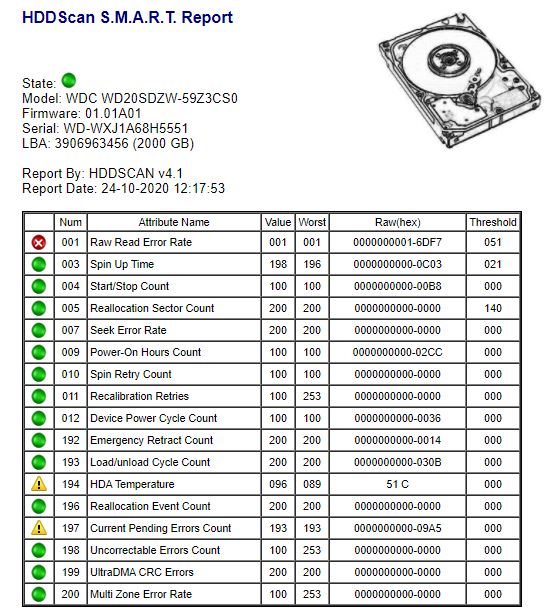

Posted: 27 Oct 2020, 19:38
by rumikodia
Also attaching screenshot of SMART Report.
Thanking You!
Posted: 27 Oct 2020, 20:01
by recuperation
You have teen times more broken sectors.
Follow this advice:
viewtopic.php?p=32264#p32264
