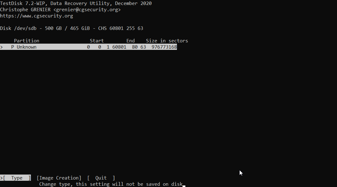

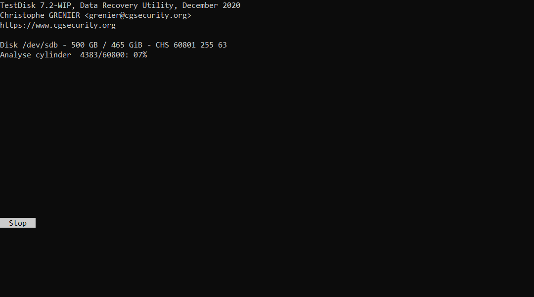

Short update: I selected GPT and it said “bad GPT partition, invalid signature” twice. Not sure what this means, but I am doing a Quick Search and it's going way slower than the other scans. Hopefully I am on the right track.

I have also uploaded a screenshot of the GPT scan I am performing right now, it will take a while before any results though. I also included the first screenshot.
Again, I apologize for the waste of time, I don't know why it didn't work.

Use deep search after the quick analysis.
