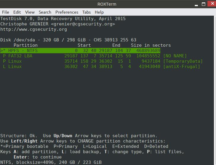

  • Testdisk says that the NTFS partition can't be recovered (3rd image). So is that the end of it? Are there any other ways of recovering the data on it? However, I tried to copy paste some small files to the live USB, which I was successful in doing. So I suppose there are still some hopes. I would continue experimenting through the night to recover as many files as possible.

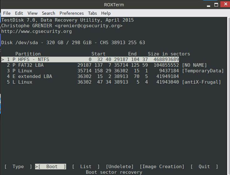

Please rerun your live operating system and use the "p"-key when being in the menu shown in screenshot1.jpg. Maybe nothing happened and your NTFS partition is still OK.
So I suppose there are still some hopes. I would continue experimenting through the night to recover as many files as possible.[/list]

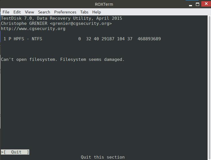

I successfully recovered the partitions and all the data on it with the help of Testdisk. After Testdisk recognized the partitions, I did, 'write & reboot' and everything was back to normal. But it got messed up again.
After that, I am not exactly sure what happened. I got carried away and the first thing I did was, I took out one of my old SD cards that was unusable, with the hopes of recovering it too. It had two partitions. One FAT32 & the other NTFS. I was not able to delete the partitions and format it. I tried all sorts without success. Then I tried by changing the NTFS file type to FAT32, also without success. So I gave up hopes and removed the SD card. However I was shocked to find that my harddrive on which there is a NTFS partition too, had aslo been changed to FAT32 and was unusable. It is the partition on which all my data resides.
I started Testdisk again, but this time it is not recognizing the partition as NTFS. It is recognizing it as a FAT32 partition. I tried to change it back to NTFS with the 't' option, but after choosing 't' the option to finalize it, i.e. 'write', does not show.

Please compare Screenshot1 of your first posting to Screenshot1 of your later posting. The NTFS partition is missing. I guess you recovered the first one.
Unfortunately your second try to recover the NTFS partition didn't show it anymore. That seems as if its boot sector has been deleted.
I would try nevertheless to create a partition manually at the old location. Maybe you have somebody around who would do that for you.
If you want to do this despite of your latest experiences I would duplicate the drive using ddrescue as described in the manual.
Then you could rerun Testdisk to see if Testdisk allows you to look inside.
Yes you are right, that is what had happened. Testdisk said so.
Since the last post, while I was working with Testdisk, it said the boot sector has gone bad but the backup boot sector is OK. Then I took cue from one of the threads from this forum which discussed similar experience, where the OP repaired the BS by using the option to repair with the backup BS. I did similarly and also changed the type from FAT32 to the original NTFS by using the 't' option. Now the partition is showing as below. However, things have not improved much. Further, the other partition which was ext4, which had also changed to FAT32, I haven't done anything about it, it still shows as FAT32.
Screenshot 1.jpg (50.74 KiB) Viewed 7969 times
There is one more thing I attempted. Since the NTFS partition has no OS on it (it earlier had the Windows OS on it, but I have removed it now.), I thought it no more needed to be a boot partition, so with the help of Gparted, I un-selected the 'boot' option in the 'Manage flags' section. I don't know if it is going to be of any help. It hasn't improved things. In Testdisk, when I go to Advanced > List, Testdisk says 'Can't open filesystem. Filesystem seems damaged.' as below.
Screenshot 4.jpg (47.7 KiB) Viewed 7969 times
Screenshot 5.jpg (29.09 KiB) Viewed 7969 times
Unfortunately, I live in a small town, where people are not acquainted with these things, the main occupation here is agriculture, so there are none to help me in this regard. Further, probably I am the only guy using Linux OS here. If at all I have to take it to the servicing center, the percentage of people using Linux is hardly 3% in the entire country and the chances of the servicing center to consider my case are almost nil. Even if they consider, the chances of resolving my issue are remote and data loss is more probable. So my best option is to seek help from the web. I am really grateful for your valuable guidance.
Further I have done other things discussed below:
Since all my data resided on the NTFS /dev/sda1, I was not much concerned about the other sections of the HDD. So I formatted the sections on which the antix-Frugal OS and the Linux-swap partitions resided with the exact previous sizes and the exact location on the disk so that it does not disturb the status of the 'NTFS /data' partition. I installed the antix-Frugal OS in its earlier location and created an ext4 partition in the earlier locations of the Swap partition as 'TemporaryData' to store some data like the screenshots that I am uploading now and to use the system at least to some extent for some work till this issue is resolved. So now the earlier Swap partition shows as 'TemoraryData' partition.
Am I right in changing the type from FAT32 to NTFS in Testdisk and un-selecting the boot option in Gparted and installing the OS and creating the 'TemporaryData' partition from Swap? Or did I mess up things further?
