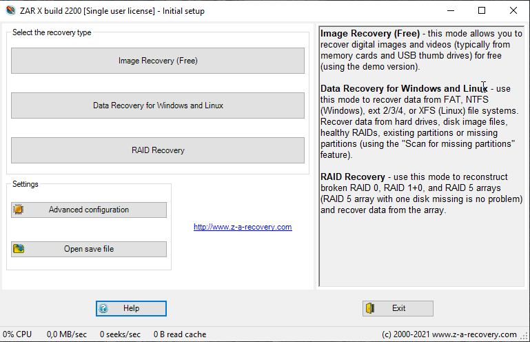

Through trial and error, as well as with help from Alexey from https://www.z-a-recovery.com (I was running into issues with ZAR, tho, self-inflicted pain - my peculiar partitioning was causing problems in the file recovery process) - with his assistance I was able to recover all my data from a non-functioning Linux software RAID0. A lot of luck was on my side as no data had been damaged, overwritten or any disks were physically damaged. But during the recovery process my 2TB of RAID data grew into ~6TB - this is because the best way to recover all my data, as it turned out, was to attempt RAID recovery, create disk images of the reconstructed RAID0 itself and then of each of the partitions residing on the RAID0 (so, 2TB for the RAID0 consisting of 1TB+1TB drives, and 1TB+500GB+400GB for the partitions residing on the RAID0 ... and since I was paranoid ~2TB for the recovered data copied back to my PC). It's worth noting that something, which I had underestimated, was how powerful the ZAR scan was, caused problems during recovery process for me - because ZAR would pick up so much metadata and file fragments from previous installations and partitions that it was hard to recover the needed data, but this could be a really useful aspect to someone else who's facing a severely damaged RAID data.
To describe the recovery process, as I mentioned above, I needed to use Windows because ZAR only supports Windows (the lack of RAID recovery tools on Linux was an unpleasant surprise), it's licensed software and you will need to purchase the licence, however, you don't need a licence if you only want to scan your drives to see if it even detects anything.

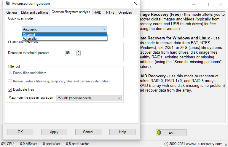

At the beginning (when I was still attempting to do individual file recovery) it seemed like the default settings weren't finding all the data and resulted in a lot of "fragments", so I followed one of the suggested solutions in the self-help resources on the website and disabled "Quick Scan" ... I did the same when creating the images for the RAID and partitions "just in case" but I think Quick Scan would have been enough. This can be done by going into the Advanced Settings when initially launching ZAR.

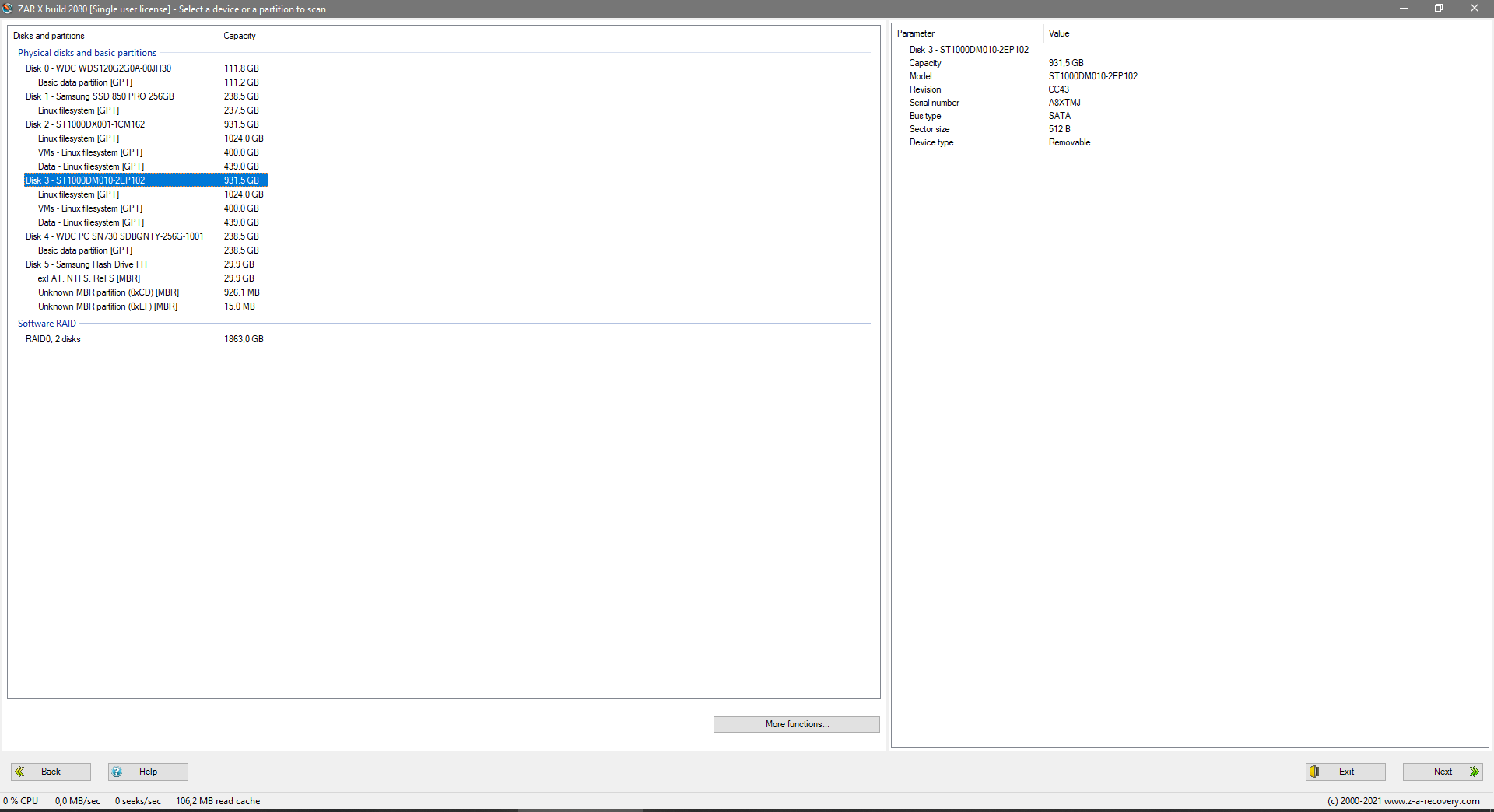

So to attempt RAID recovery I went with the "RAID Recovery" on the main menu and selected the two hard disks, which, held my RAID0 (sorry, no pictures of this step, I selected the two disks in any order and allowed software to scan them).
After it had found my RAID with a disk missing, I selected it from the list and then proceeded to create a disk image - for this, I used another externally attached disk on which to store the RAID image.

To create the image I clicked on "More Functions" (created a new screenshot without RAID loaded, so in my screenshot the option is greyed out, but for you it shouldn't be)
After I had the RAID image created, I'd use the "Data Recovery for Windows and Linux" and load the disk image, then, in the same fashion as the RAID image was created, select one of the lost partitions and create a new disk image.

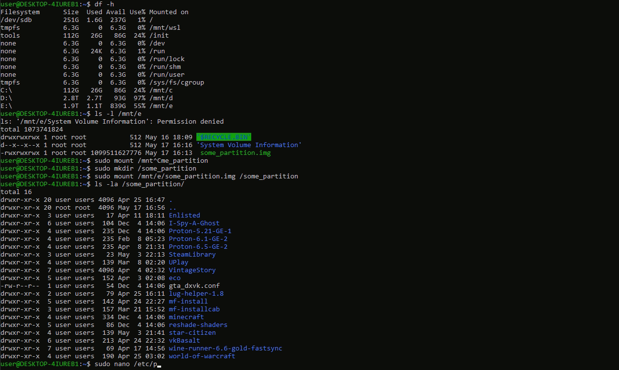

Later, when I had all the disk images, I was able to mount the disk images of each partition on my Linux PC via:
sudo mount -o loop ./VM_image.img /mnt

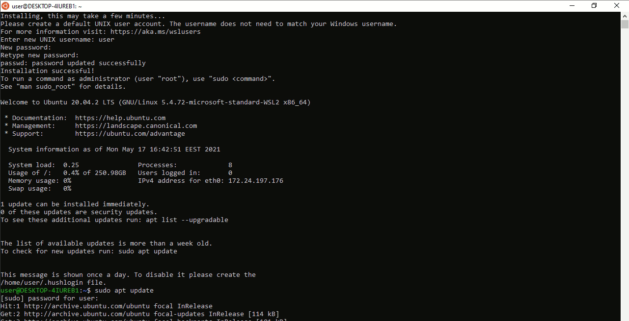

Additionally, during this I learned that WSL2 (Windows Subsystem for Linux) was capable to mount my XFS partitions - https://devblogs.microsoft.com/commandl ... and-wsl-2/
Which I also tried out successfully by mounting 'Games' partition (because it held no valuable data and I wasn't worried if any would get corrupted/damaged during these tests) on Windows 10 updated to 20H2, note - I used Ubuntu from Windows Store.
