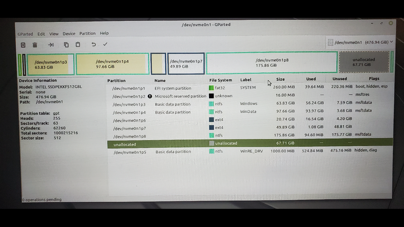

I have a duel boot T480 laptop with preinstalled Windows 10. Once I bought it, I resized the C:\ drive, using gParted I created additional partition for storage (D:\, 50gb and F:\, 100gb) and other ext4 partitions and installed Linux Mint 19. I’ve been using this setup for last year or so. D:\ was not being used since its creation using gParted.
Few days ago, while I was logged into windows10, I formatted the unused D:\ drive. The first clue something was wrong was when the partition size was 175gb instead of 50gb that I created. I created one empty folder from windows after I formatted the partition. After this process this is how my partitions look like.https://imgur.com/pGuTlot. I dont see the windows recovery partition etc.

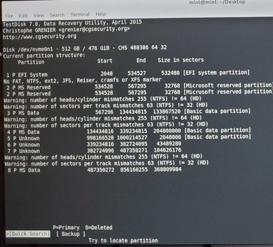

Tried testdisk:
This is what I got after first https://imgur.com/lMdwuGu.
The next step was quicksearch. This is what I got after quicksearch https://imgur.com/EpGI1nB. There are many partitions marked with "D". I tried looking at files using option "p", I don't see the files that I'm looking for (my home directory or sub folders like desktop etc).
What should my next step? If someone can help me with step by step instructions, I will be able to try it out. I will accept responsibility for the loss of data because of these efforts, so please don’t hesitate to offer your ideas. Is this issue something like recreating MBR of MFT (don't know how or even if it is possible, since I’m at noob level)

attached is the gParted output from liveUSB. the 175gb partition was created after I formatted the 50gb NTFS partition. I think this partition swallowed the linux home folder that contained my files.
- 20210530_220520.jpg (365.52 KiB) Viewed 2988 times
- 20210530_220224.jpg (214.88 KiB) Viewed 2988 times
- This is the gParted output from liveUSB
- gParted.png (498.6 KiB) Viewed 2990 times
