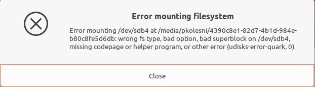

I've lost all my data on WD MyBookLive 2TB as many others.
I've connected disk to Ubuntu using external SATA to USB adapter.
I've started with standard disk utility from Ubuntu, it shows
Disk: WDC WD30 EZRS-11J99B1 (0100)
Size: 802 GB (801 569 726 464 bytes) :o Opps!
Partitioning: Unknown (PMBR)
fdisk utility shows:
$sudo fdisk -l /dev/sdb
Disk /dev/sdb: 746,53 GiB, 801569726464 bytes, 1565565872 sectors
Disk model: EZRS-11J99B1
Units: sectors of 1 * 512 = 512 bytes
Sector size (logical/physical): 512 bytes / 512 bytes
I/O size (minimum/optimal): 512 bytes / 512 bytes
Disklabel type: dos
Disk identifier: 0x00000000
Device Boot Start End Sectors Size Id Type
/dev/sdb1 1 4294967295 4294967295 2T ee GPT
gdisk utility shows:
$sudo gdisk -l /dev/sdb
GPT fdisk (gdisk) version 1.0.5
Warning! Disk size is smaller than the main header indicates! Loading
secondary header from the last sector of the disk! You should use 'v' to
verify disk integrity, and perhaps options on the experts' menu to repair
the disk.
Caution: invalid backup GPT header, but valid main header; regenerating
backup header from main header.
Warning! One or more CRCs don't match. You should repair the disk!
Main header: OK
Backup header: ERROR
Main partition table: OK
Backup partition table: ERROR
Partition table scan:
MBR: protective
BSD: not present
APM: not present
GPT: damaged
Caution: Found protective or hybrid MBR and corrupt GPT. Using GPT, but disk
verification and recovery are STRONGLY recommended.
Disk /dev/sdb: 1565565872 sectors, 746.5 GiB
Model: EZRS-11J99B1
Sector size (logical/physical): 512/512 bytes
Disk identifier (GUID): 0DA7894D-0CAE-4FE5-A883-3B134C5E4FE3
Partition table holds up to 128 entries
Main partition table begins at sector 2 and ends at sector 33
First usable sector is 34, last usable sector is 5860533134
Partitions will be aligned on 2048-sector boundaries
Total free space is 31597 sectors (15.4 MiB)
Number Start (sector) End (sector) Size Code Name
1 1032192 5031935 1.9 GiB FD00 primary
2 5031936 9031679 1.9 GiB FD00 primary
3 30720 1032191 489.0 MiB 0700 primary
4 9031680 5860532223 2.7 TiB 0700 primary
gdisk /dev/sdb with option v shows
Command (? for help): v
Caution: The CRC for the backup partition table is invalid. This table may
be corrupt. This program will automatically create a new backup partition
table when you save your partitions.
Problem: The secondary header's self-pointer indicates that it doesn't reside
at the end of the disk. If you've added a disk to a RAID array, use the 'e'
option on the experts' menu to adjust the secondary header's and partition
table's locations.
Problem: Disk is too small to hold all the data!
(Disk size is 1565565872 sectors, needs to be 5860533168 sectors.)
The 'e' option on the experts' menu may fix this problem.
Problem: GPT claims the disk is larger than it is! (Claimed last usable
sector is 5860533134, but backup header is at
5860533167 and disk size is 1565565872 sectors.
The 'e' option on the experts' menu will probably fix this problem
Problem: partition 4 is too big for the disk.
Partition(s) in the protective MBR are too big for the disk! Creating a
fresh protective or hybrid MBR is recommended.
Identified 6 problems!
Recovery/transformation command (? for help): p
Model: EZRS-11J99B1
smartctl shows
$smartctl --all /dev/sdb
smartctl 7.1 2019-12-30 r5022 [x86_64-linux-5.4.0-74-generic] (local build)
Copyright (C) 2002-19, Bruce Allen, Christian Franke, www.smartmontools.org
Model Family: Western Digital Caviar Green (AF)
Device Model: WDC WD30EZRS-11J99B1
Serial Number: WD-WCAWZ1033320
LU WWN Device Id: 5 0014ee 2b0c32bc8
Firmware Version: 80.00A80
User Capacity: 3 000 592 982 016 bytes [3,00 TB]
ATA Version is: ATA8-ACS (minor revision not indicated)
SATA Version is: SATA 2.6, 3.0 Gb/s
Local Time is: Mon Jun 28 16:19:09 2021 MSK
SMART support is: Enabled
General SMART Values:
Offline data collection status: (0x82) Offline data collection activity
was completed without error.
been run.
data collection: (50280) seconds.
capabilities: (0x7b) SMART execute Offline immediate.
command.
Self-test supported.
power-saving mode.
Short self-test routine
Extended self-test routine
recommended polling time: ( 483) minutes.
Conveyance self-test routine
recommended polling time: ( 5) minutes.
SCT capabilities: (0x3035) SCT Status supported.
SCT Data Table supported.
1 Raw_Read_Error_Rate 0x002f 200 200 051 Pre-fail Always - 0
3 Spin_Up_Time 0x0027 176 139 021 Pre-fail Always - 8191
4 Start_Stop_Count 0x0032 064 064 000 Old_age Always - 36900
5 Reallocated_Sector_Ct 0x0033 200 200 140 Pre-fail Always - 0
7 Seek_Error_Rate 0x002e 200 200 000 Old_age Always - 0
9 Power_On_Hours 0x0032 001 001 000 Old_age Always - 80408
10 Spin_Retry_Count 0x0032 100 100 000 Old_age Always - 0
11 Calibration_Retry_Count 0x0032 100 253 000 Old_age Always - 0
12 Power_Cycle_Count 0x0032 100 100 000 Old_age Always - 84
192 Power-Off_Retract_Count 0x0032 200 200 000 Old_age Always - 46
193 Load_Cycle_Count 0x0032 001 001 000 Old_age Always - 1835471
194 Temperature_Celsius 0x0022 108 075 000 Old_age Always - 44
196 Reallocated_Event_Count 0x0032 200 200 000 Old_age Always - 0
197 Current_Pending_Sector 0x0032 200 200 000 Old_age Always - 1
198 Offline_Uncorrectable 0x0030 200 200 000 Old_age Offline - 0
199 UDMA_CRC_Error_Count 0x0032 200 200 000 Old_age Always - 0
200 Multi_Zone_Error_Rate 0x0008 200 200 000 Old_age Offline - 0
SMART Error Log Version: 1
ATA Error Count: 1
CR = Command Register [HEX]
FR = Features Register [HEX]
ER = Error register [HEX]
ST = Status register [HEX]
Error 1 occurred at disk power-on lifetime: 1243 hours (51 days + 19 hours)
ER ST SC SN CL CH DH
04 41 40 b8 84 4e e0 Error: ABRT 64 sectors at LBA = 0x004e84b8 = 5145784
CR FR SC SN CL CH DH DC Powered_Up_Time Command/Feature_Name
c8 00 40 b8 84 4e e0 08 45d+01:57:54.541 READ DMA
Num Test_Description Status Remaining LifeTime(hours) LBA_of_first_error
# 1 Short offline Completed without error 00% 14872 -
# 2 Extended offline Completed without error 00% 24359 -
# 3 Short offline Completed without error 00% 24351 -
# 4 Short offline Completed without error 00% 22878 -
# 5 Short offline Completed without error 00% 14212 -
# 6 Short offline Completed without error 00% 2254 -
# 7 Short offline Completed without error 00% 0 -
1 0 0 Not_testing
2 0 0 Not_testing
3 0 0 Not_testing
4 0 0 Not_testing
5 0 0 Not_testing
Now I'm waiting for testdisk results.
Any advice or recommendation?

#5 Post by recuperation »
Your log already shows one inaccessible sector.
Your problems might not necessarily been caused by the WD security problem but by a failing drive.
Duplicate your drive using ddrescue as described in the manual and rerun smartmontools as broken sector information will have been updated afterwards.
Please document your recovery process using text and screenshots. So far I can't see what you did.

I've bought new HDD and start recovery procedure.
My new HDD is WDC WD30EZAZ-00SF3B0
pkolesni@pkolesni-HP:~$ sudo smartctl -d usbjmicron,0 -i /dev/sdb
smartctl 7.1 2019-12-30 r5022 [x86_64-linux-5.4.0-91-generic] (local build)
Device Model: WDC WD30EZAZ-00SF3B0
Serial Number: WD-WX32D6123X1S
LU WWN Device Id: 5 0014ee 21451eb54
Rotation Rate: 5400 rpm
Form Factor: 3.5 inches
Device is: Not in smartctl database [for details use: -P showall]
ATA Version is: ACS-3 T13/2161-D revision 5
SATA Version is: SATA 3.1, 6.0 Gb/s (current: 1.5 Gb/s)
Local Time is: Mon Jan 3 00:02:04 2022 MSK
pkolesni@pkolesni-HP:~$ sudo gdisk -l /dev/sdb
MBR: not present
BSD: not present
APM: not present
GPT: not present
Creating new GPT entries in memory.
Model: EZAZ-00SF3B0
Disk identifier (GUID): 98F71ACD-E0F9-46D8-83C0-2671FE9CE3B9
First usable sector is 34, last usable sector is 1565565838
Total free space is 1565565805 sectors (746.5 GiB)
I made back up GPT data to a file
pkolesni@pkolesni-HP:~$ sudo gdisk /dev/sdc
the disk.

But I can't mount partition 4 using disk utility. Get error message in attach.
wrong fs type, bad option, bad superblock on /dev/sdb4, missing codepage or helper program, or other error (udisks-error-quark,0)
Any ideas how can I mount this partition and restore my data?

Posts: 3187
Re: Lost data on MyBookLive
#9 Post by recuperation »
If you can't find content using the p-key ("list files") use Photorec or some other recovery software.
