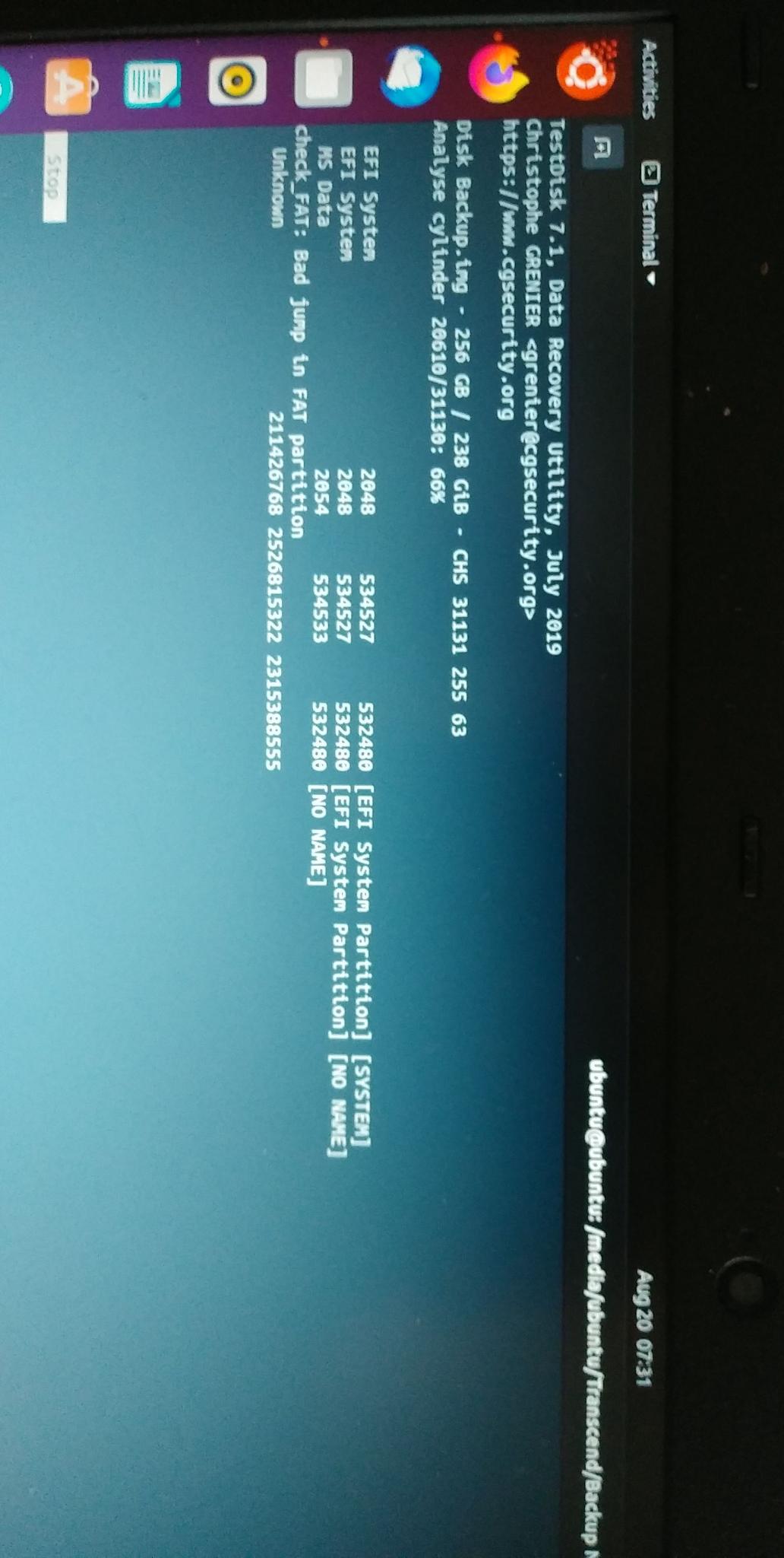

I used ddrescue to create an image of the whole drive to an external ssd with enough space (>300gb free) which seemed to work perfectly with just a teeny tiny bit of data lost - what I thought would be the reason why it can't boot:
https://ibb.co/JqZKm7Q
However, as you can see: parted had a problem with an "unrecognized disk label"

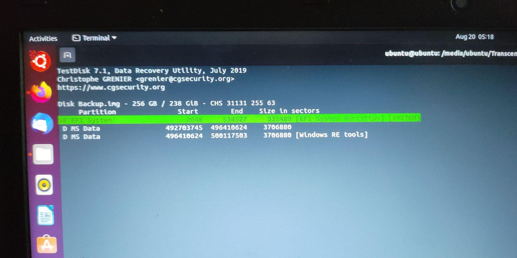

So what I did next was downloading testdisk to see what I can find. I started with a run on the Intel partition althought it showed me EFI as I was following a video tutorial. It ended up only showing 2 partitions with a huge gap in the middle.
In the next run I tried EFI and right after I click analyse I can see all those partitions:
https://ibb.co/7jjFCsg

During the search the first error pops up:
https://ibb.co/G5NP8F9
Which is followed (after a while) by:
https://ibb.co/sjtG2Zw
I hit enter and the result of the deep search at the end is:
https://ibb.co/pzzk7bh

Picture 2: Partitions shown after Analyse

Picture 5: Error2_Partition cant be rescued

in testdisk, select the disk you need (file size should be about 128/119 GB for surface laptop 1st gen)
select the partition type you want to look for (strangely in this case it seems to be EFT even though it's windows, I assume it's because of bitlocker or something).
select advanced
you should see a list of partitions and one partition that has way more data than the rest. This is the one you want to make an image of. (mine was called 'ms data')
Select the partition with all the data and choose 'image creation'
browse to /mnt/backup (or where ever you mounted your external drive) then press 'C' to select that location to save the image.dd to.
Now you just wait for a bit for the image to finish.
