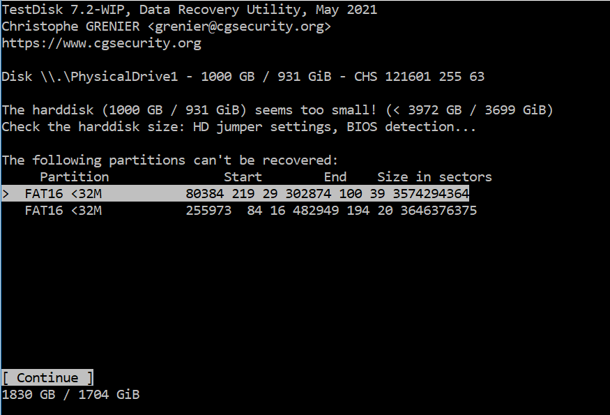

I bought a Buffallo Ministation External HDD a few years back. Recently it won't get read by the computer and the case does not light up anymore. I tried to replace the case and found that inside it is a TOSHIBA MQ01ABD100 model. Now using the new case I bought it does not show in the explorer. When I use "disk management" application in Windows, it shows as unallocated disk. I searched for a partition recovery tool which led me here. I've already run Test Disk but did not get to restore my HD. So I checked the logs and now ask anyone to help me on what this means?
Analyse Disk \\.\PhysicalDrive1 - 1000 GB / 931 GiB - CHS 121601 255 63
BAD_RS LBA=41024 64
BAD_RS LBA=1291382785 9730037
FAT16 <32M 80384 219 29 302874 100 39 3574294364
This partition ends after the disk limits. (start=1291382785, size=3574294364, end=4865677148, disk end=1953525167)
BAD_RS LBA=4112211552 9364958
FAT16 <32M 255973 84 16 482949 194 20 3646376375
This partition ends after the disk limits. (start=4112211552, size=3646376375, end=7758587926, disk end=1953525167)
The harddisk (1000 GB / 931 GiB) seems too small! (< 3972 GB / 3699 GiB)

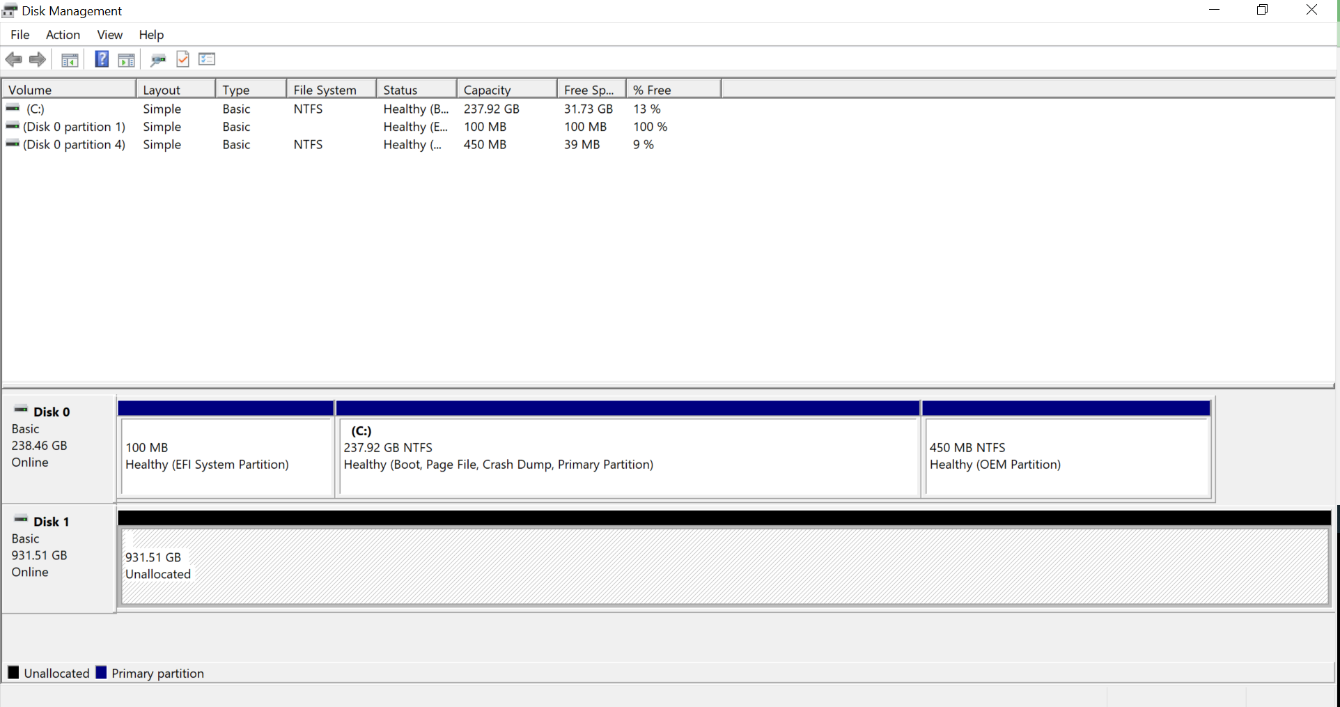

Here is a screenshot from Disk Management
Currently it doesn't show as a volume in my "Windows Explorer".

Re: How to recover my External Hard Disk being read as unknown
I am attaching the picture here inline. Thank you.

also attaching the result after quick search
