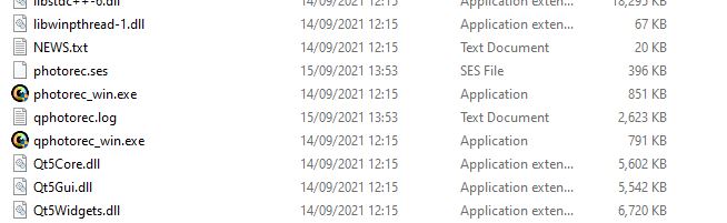

Here is a link where you can see the jump happening in the very last split second of the video.

Where is qphotorec_win.exe located?
Do you start that from a USB stick?
When restarting Qphotorec_win.exe does photorec.ses exist?

The HDD is partitioned as D:, E: and F:
Lost data are on E:
QPhotoRec is started from F:\install\photo recovery\testdisk-7.2-WIP
Data is saved on an attached Seagate Expansion Drive
To get at 36% from 2.2T partition takes about 12 hours?
It can stay at that jump and drop position for days. (tested and confirmed, no further progress)

When it looks like Photorec or Qphotorec is ignoring its own files (Photorec.ses) something is very rotten!
That's why I asked:

Sorry that I didn't answer all questions.
The ses file resides in the same subdirectory as the exe file.
Additional information:
- QPhotoRec wants to start as if no ses file exists.

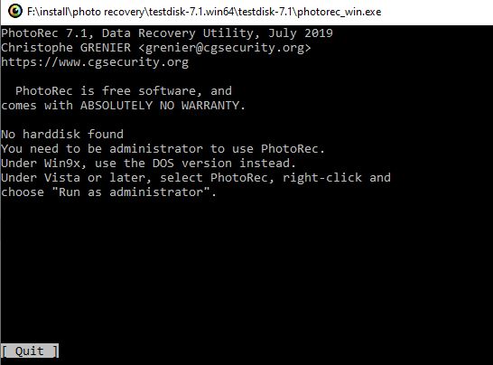

- PhotoRec does ask to continue and the next question it asks is to start it as Administrator.

#8 Post by recuperation »
Please backup the photorec.ses file to some other location.
If you restart QPhotorec now, will you be asked to continue the old session?

I have another video of the failure: https://www.dropbox.com/s/fpy1teuvspn7h ... 2.mp4?dl=0
It jumpes back around 165811xxxxx and a bit more
qphotorec_win.exe doesn't notice the existence of the ses file
photorec_win.exe , when started as administrator displays the following screen.
I wonder, is it possible to make it start somewhere at sector 166000xxxxx ?

#10 Post by recuperation »
What's your operating system?
Do you run it in a virtualized environment?
As both versions of Photorec use the ses file
viewtopic.php?p=24705#p24705
you have a problem with your setup.
Please provide a detailed report about the hardware and software used.
Use Photorec with administrative rights.
Recognition of the ses file is mandatory for your purpose.
Here is a hint how to set the starting sector for Photorec:
viewtopic.php?p=19421#p19421
