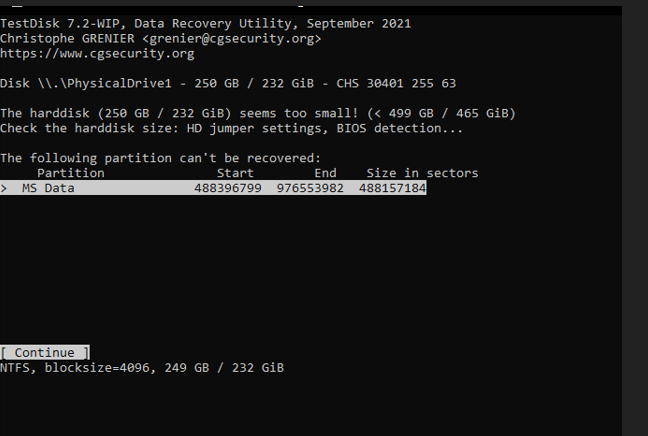

After analyzing in test test since its in EFI GPT
this is the result
I continued on and I found out that I had 2 partitions that are 250GB one for windows and one for ubuntu. I don't really mind about the Ubuntu but I need to recover the files in windows. Tried writing it but testdisk tells me Partition: write error. I could see the correct list of files and tried copying them but it also failed.

Your title is "recovering..." but in your text you speak about repairing. I can't help you in repairing a physically dammaged drive and don't support extensive repair of a dammaged file system.
Although I don't have experience with NVM type SSD storage the SMART attributs 0E anf 0F suggests that your drive is broken and switched into read only mode.
Please publish a SMART report as described here:
viewtopic.php?f=5&t=10910
I would duplicate the drive as described in the manual and try to recover content from the duplicate.
It appears that you tried to write the selected file onto the broken NVM type SSD:
If you had chosen a different and healthy storage location to write the files to it might have worked.
