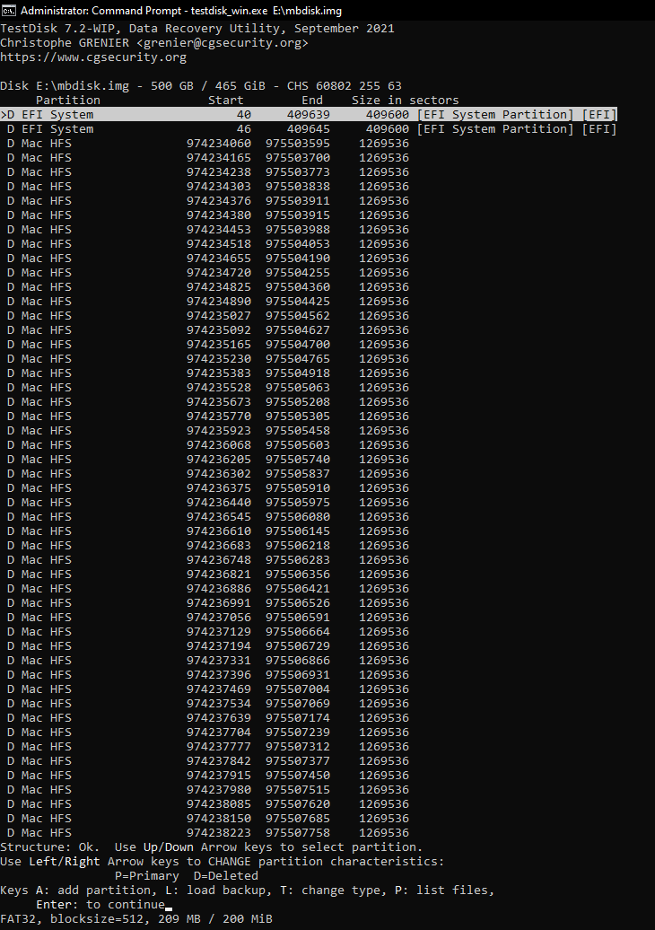

I've taken a dd img of a drive from an old apple laptop I own. I'm trying to recover data from the "Apple Core Storage" partition. I'm aware that there's a HFS+ partition wrapped in there, and that I need to do a calculation to set a limit on mount. However, TestDisk isn't giving me the response I expected as can be seen below.
1) On loading up an image with TestDisk I get the following:

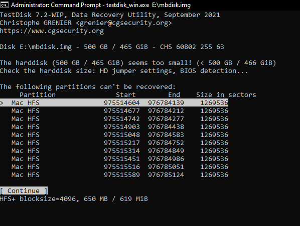

2) So, I proceed with a quick scan with the following result:
You can see that the middle partition, the one I'm interested in, is not listed.

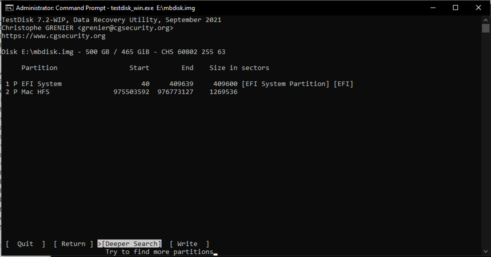

3) I proceed with deeper scan and I get:

TestDisk can not (for the moment) recover lost Apple Core Store partition but you don't need to recover a lost partition, so it's not really a problem.
If PhotoRec didn't recover meaningful files, it's probably because the filesystem is encrypted.
Unfortunately I have no solution in this case.
