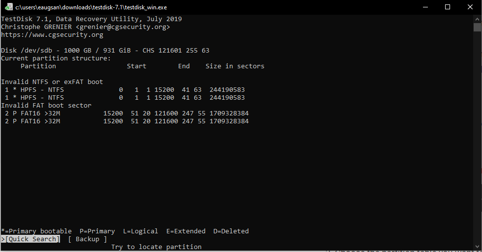

In the Disk Management apparently there are 2 partitions, I can't actually remember having 2...but 1...
I downloaded and used TestDisk 7.2 Beta without success for now.
I followed 2 approaches in the User manual :
1) RECOVERING DELETED PARTITION USING TESTDISK
I followed all steps and apparently 2 partitions are there but i got nothing after step 9.6: Quick Search of partitions (which is nothing but quick, it took like 8h)

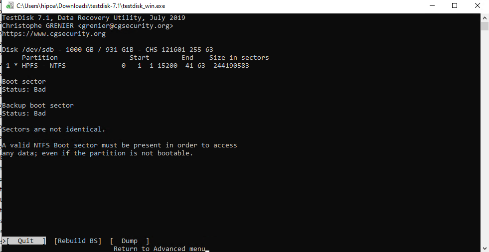

2)TestDisk: Repairing NTFS boot sector
start testdisk
• select the device containing the partition (avoid drive letter like D:)
• confirm the partition table type
• go in the Advanced menu
• select the NTFS partition
• choose Boot
• select RebuildBS -> after this step nothing appeared, I would not choose "List" as stated in de user manual 7.6 section

Re: Disk in RAW
I am a noob. What next ? it was just a power failure. Partitions and data should be recoverable right? What am i doing wrong?
I followed the Testdisk steps for Boot sector fix and Partition recovery but no readable partition comes up
What is the ddrescue you suggest, where will all drive go to and how to get the data inside afterwards?
(i guess I'lll need a 1TB additional drive?)
- 2021-12-03_15-13-11.png (85.6 KiB) Viewed 12616 times
- 2021-12-03_15-12-57.png (76.2 KiB) Viewed 12616 times
- 2021-12-03_19-38-21.png (32.58 KiB) Viewed 12616 times
