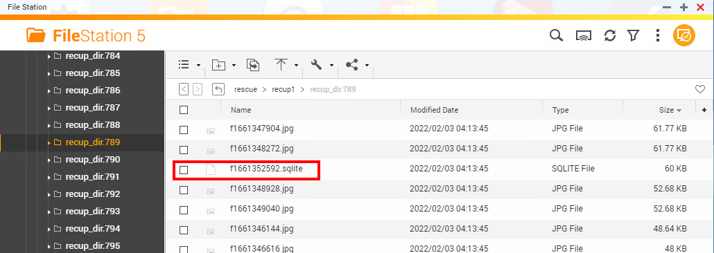

Check if you find your data in the recup_dir.* directories created by PhotoRec. PhotoRec may have recover your db files with a sqlite extension.

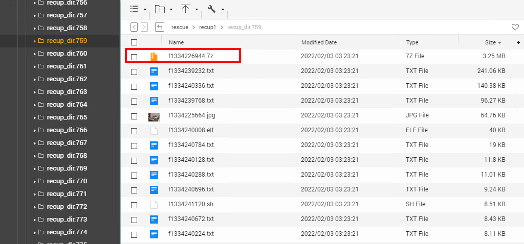

thx for your response. I realy apprisiate. Yes, I can confirm, I see some of the recoverd photos. I have like 795 dirs. But sill lot of .7z files (and other file formats) that are photo size.
How can I fix that? How can I change to perhubs maria db?
