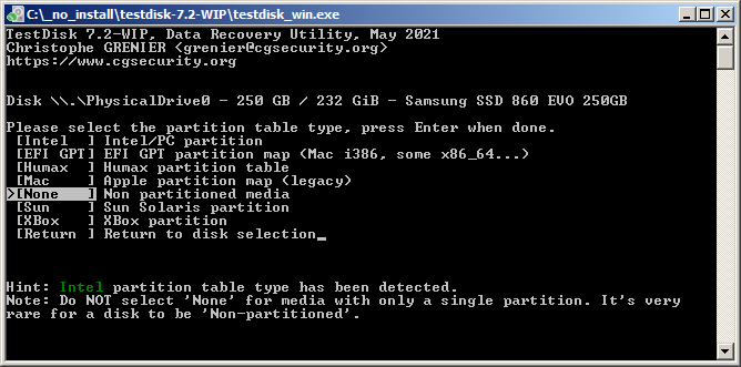

It's good that you know! Testdisk can't really tell you if you crushed the partition table. It presents you possible partitions based on data that look like the boot sector of a partition and you have to verify those proposals.
There were 3 that I created, Vol 1,2 (encrypted),3. I think I chose the default 'no partition'.
Do you mean "none" as selected in the following picture?
If you had three partitions you must have had a partition table when running windows. "None" is wrong in your case.

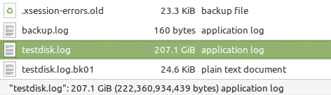

Update: here are the first 200 lines:
$ cat testdisk.log | head -n 200

erw1 wrote: 10 Jun 2022, 12:15 I'm beginning to understand there are three different words for a given partition type, that is, MBR=Windows=Intel,
No. The menu is about to select the partition table type that was used. A partition table keeps track of locations, lengths and types of partitions.
In the old MBR scheme the type no. 7 was used by Microsoft for NTFS partitions but it could have different meanings as well:
https://en.wikipedia.org/wiki/Partition_type
and one can deduce it is the choice that has been made to run the analysis based on "Your screen is filled with found partitions in CHS (cylinder, head, sector) adresses."
In a GPT partition table there are no triplets in CHS-style anymore. A sector is determined by just one number.
This level of guesswork maybe suitable for some people, but for me it just contributes to a feeling of helplessness.
I am sorry for that but Testdisk is a professional tool not aiming at computer starters. There is no beautiful graphical user interface taking you by the hand. But in a world with internet you can research things and terms that you do not understand and in this area for instance you get good answers even if you are only looking at Wikipedia.

In case it sparks any comment towards the resolution of my problem, here's the new analysis (the third) that I started x hours ago. It was before going to bed, and I don't remember what partition type it is. The log file is 207GB in size, which is insane.
Log files are typically much smaller than that, maybe some kBytes or even some 10kBytes. Testdisk fails to read sectors. Your disk is broken. Instead of stressing the disk using Testdisk you should have checked the SMART parameters:
