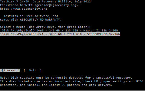

I want to use 'load backup' functionality of testdisk to recover my lost partitions.
I have two hard disks, 240 GB Solid state drive from which I boot, and 3TB Seagate drive for which I want to recover partitions:
This is the initial analyse screen:

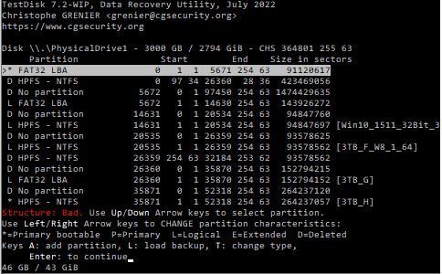

This is the quick search screen:
Since all my partitions were not detected in quick search (or even deeper search), I opted to load backup:
Screenshot 1 Disks
Screenshot 1 Disks
Screenshot 2 Analyse

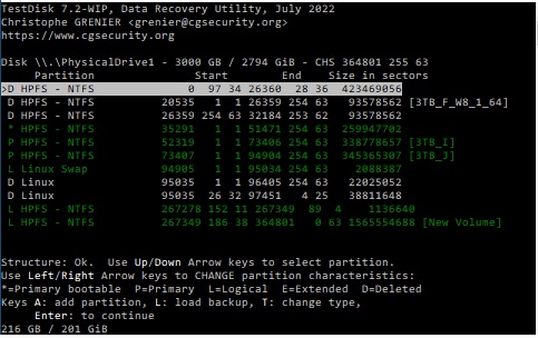

Screenshot 3 Quick search
It loads following backup, and even here all the partitions are not shown:
I think this backup shown here corresponds to following file:

3 P HPFS - NTFS 20535 1 1 26359 254 63 93578562 [3TB_F_W8_1_64]
4 E extended LBA 26360 0 1 293709 89 3 4294967295
X extended 26360 0 63 35870 254 63 152794153
Bad relative sector.
5 L FAT32 LBA 26360 1 1 35870 254 63 152794152 [3TB_G]
X extended 35871 0 63 52318 254 63 264237058
6 L HPFS - NTFS 35871 1 1 52318 254 63 264237057 [3TB_H]
X extended 52319 0 63 73406 254 63 338778658
7 L HPFS - NTFS 52319 1 1 73406 254 63 338778657 [3TB_I]
X extended 73407 0 2 94904 254 63 345365369
8 L HPFS - NTFS 73407 1 1 94904 254 63 345365307 [3TB_J]
X extended 94905 0 63 95034 254 63 2088388
9 L Linux Swap 94905 1 1 95034 254 63 2088387
X extended 95035 26 31 97451 4 25 38811649
10 L Linux 95035 26 32 97451 4 25 38811648
X extended 267349 154 6 293709 89 3 423469303
Disk \\.\PhysicalDrive1 - 3000 GB / 2794 GiB - CHS 364801 255 63

get_geometry_from_list_part_aux head=255 nbr=12
HPFS - NTFS 0 97 34 26360 28 36 423469056
NTFS found using backup sector, blocksize=4096, 47 GB / 44 GiB
HPFS - NTFS 26359 254 63 32184 253 62 93578562
NTFS, blocksize=4096, 47 GB / 44 GiB
* HPFS - NTFS 35291 1 1 51471 254 63 259947702
NTFS, blocksize=4096, 133 GB / 123 GiB
P HPFS - NTFS 52319 1 1 73406 254 63 338778657 [3TB_I]
NTFS, blocksize=4096, 173 GB / 161 GiB
P HPFS - NTFS 73407 1 1 94904 254 63 345365307 [3TB_J]
NTFS, blocksize=4096, 176 GB / 164 GiB
SWAP2 version 1, pagesize=4096, 1069 MB / 1019 MiB
Linux 95035 1 1 96405 254 63 22025052
ext4 blocksize=4096 Large_file Sparse_SB, 11 GB / 10 GiB
ext4 blocksize=4096 Large_file Sparse_SB Backup_SB, 19 GB / 18 GiB
L HPFS - NTFS 267278 152 11 267349 89 4 1136640
NTFS, blocksize=4096, 581 MB / 555 MiB
L HPFS - NTFS 267349 186 38 364801 0 63 1565554688 [New Volume]
NTFS, blocksize=4096, 801 GB / 746 GiB
This is the screenshot after quick search is completed:
I am running deep search and I will post the log after it is completed please.
