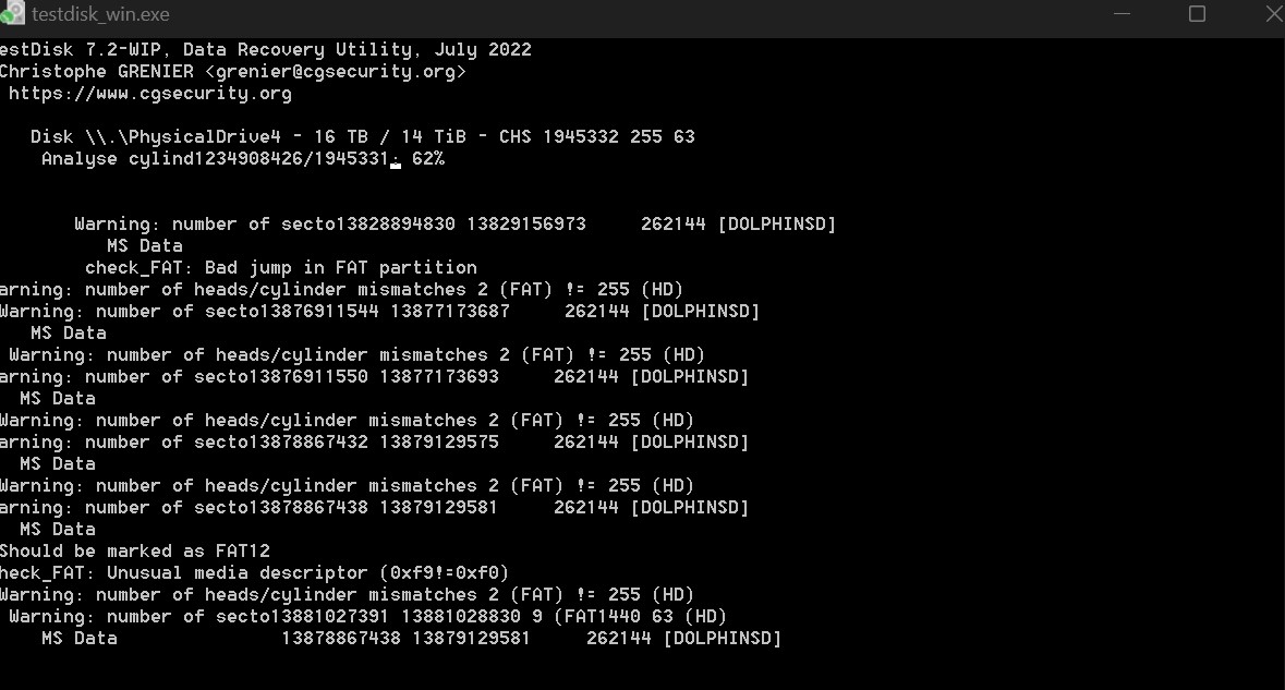

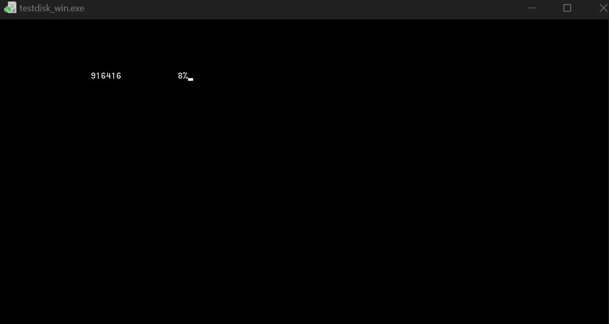

Scanning HD 6 of 11 days remaining. weird errors
wanted to see if you could advise. It has been difficult not to reboot for two weeks straight so the disk analysis can finish. I am 62% completed after 7 days, my initial estimate was 11 days but it looks like I was off by a bit.

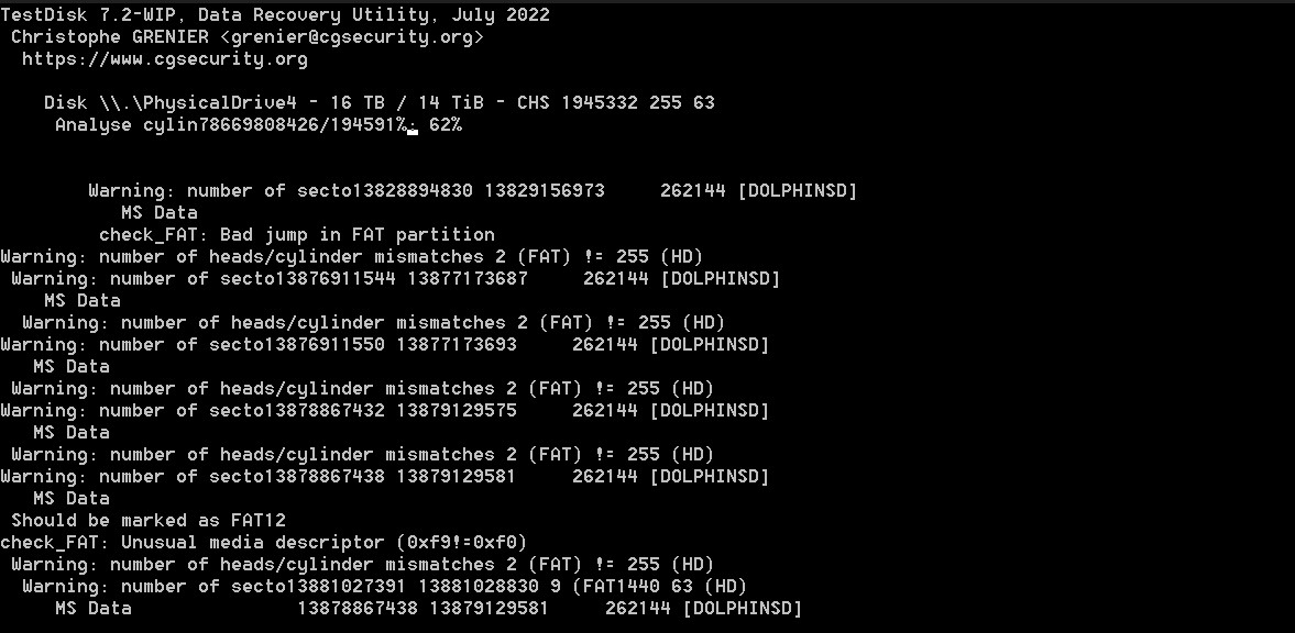

In any case, here are the warning shown thus far (see screenshot)

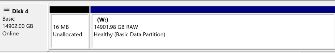

This is the 14Tb drive chkdsk refuses to run (no space) and shows as RAW. Fire recovery restores partial files.
Any advice or thoughts to improve my odds? thank you very much.

Re: Scanning HD 6 of 11 days remaining. weird errors
0.
1. Win 11 pro build 22621.ni_release220506-1250, I have several VMs with access including Uduntu 2022-6-13, windows 10
2. 7.2_WIP July 2022 (downloaded latest 10 days ago, still running. shows 91% complete (I think see attachments
3. I did not, but the system is showing RAW and read only from windows so YES
4. None of the above. See #3
5.Data drive
6. HDD
7. 16TB
8. Toshiba Enterprise MG series
9. MG08ACA16TE
10. Naked as a jailbird
11.
11.5 HDD device firmware (latest as of 2022/8/24) 0102
12. GPT
13. Two partitions as far as I know, but this drive is crazy weird. What I initially configured was one GPT partition. Windows shows 16mb unallocated, second partition 14901.98 GB RAW Healthy NTFS GPT
14. yes.
15 yes
14 #2 - Put two 16TB drives on USB 3.0 docking station. copied files from smaller drives to new drives. Memory stick went bad, caused system hangs other issues. Once I got that corrected, identified windows saw drive as RAW , checkdsk refuses to run (states 0 space available)
15 #2 - no physical issues
16. no bitlocker or other encryption
17. n/a
Still seeing the weird status, but finally figured out there is an updated % provided it is at 91% and still running..
12. GPT
14. yes.
15 yes
17. n/a
Drive was brand new, and never fell physically.
Your question was what happened to cause the problem. I had a stick of RAM go bad, causing BSOD reboots randomly for a week until I diagnosed the RAM was bad.
Any experience with mismatch heads/cylinder errors or bad jumps in the FAT partition?
the last screen looks like garbage info.
I am broke. best thing I can do is buy a new drive for up to 30 days then return it. I am broke. My experience with warranty repairs form Toshiba is data is lost unless I spend a fortune, or it will take more than 26 days (time to duplicate, redupe)
thank you for your expertise.
-Rob
-Rob
Your drive recorded a shock. It does not tell you when that shock happened.
You can ignore it as your operating system does not use CHS-adressing for reading and writing sectors.
Check the partition list for readable content, even if everything looks like garbage.
-Rob
Rob, I have no idea why people buy those large drives! In case of recovery of a maybe defective drive you need another one to generate a physical clone and a third one as a duplicate of the 2nd one. Why not 2 x 8 TB or 4 x 4TB?
