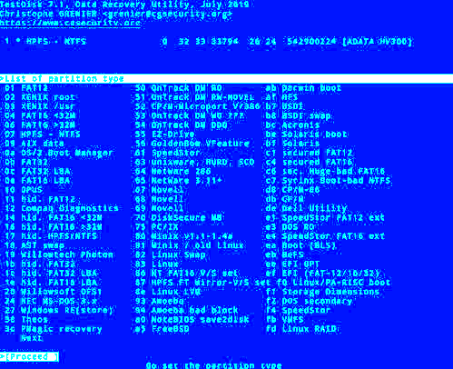

After being hung on a protracted exFat to NTFS sloppy windows conversion..... each and every file other than text file are now corrupted in the sense that when I open a JPEG file, I get something to the tune of unexpected offset ya-da-ya . this is the direct result of failed conversion of existing content. New content if added though I will not add, is just fine on the existing NTFS newly converted file system
In test disk advanced options I tried to change the partition type but there is no other option that leads me to exFat & as I understand it is the same option as NTFS but the boot sector content makes them different. as I notice the backup boot sector condition is bad but the primary boot sector is ok.
please advise on how to retorate back to exFat the corrupt files can be so as to say "uncorrupted " or whatever other solution applies to the situation.

Last ray of hope ...is there any way I can get the partition to table to use the backup sector and get itself identified as exFAT instead of NTFS. Here in the screenshot there isn't a way to tell exFAT. Photorec is for deleted pics. These aren't deleted. They exist and have their original size as well , which is why I am a tad hopeful ..... but they have some kinda header ( ?) cos of exFAT to NTFS conversion cos when I try and open em I get this

Please post your logfile.
Please replace your unreadable screenshots by ones that you saved as a png-file. Selecting contrasting colours and using a convenient screensize might enable me to read the screenshot without the need to dunk my head nearly into the LCD screen. Thank you!
sieger007 wrote: 05 Sep 2022, 20:53 Last ray of hope ...is there any way I can get the partition to table to use the backup sector and get itself identified as exFAT instead of NTFS. Here in the screenshot there isn't a way to tell exFAT.
True. I can't read anything about exFAT either because I can't read anything at all. See above!

Thanks for that useful clarification. But can Photorec handle, not deleted , but corrupted files , and help fix these. My problem is these files haven't vanished... as in a format or lost partition . They are there but due to the issue mentioned so , can't be read aka they have gone bad.

sieger007 wrote: 06 Sep 2022, 00:39 Thanks for that useful clarification. But can Photorec handle, not deleted , but corrupted files , and help fix these. My problem is these files haven't vanished... as in a format or lost partition . They are there but due to the issue mentioned so , can't be read aka they have gone bad.
Photorec can recover files that are not fragmented. Fragmented files are files whose content is saved kind of randomly all over your volume/partition.
If your files are fragmented it doesn't matter if they did not vanish once the associated metadata is broken. The metadata is for instance then information about the files' names and their location.
Your linux file system tried to open up a jpeg file but does not find a jpeg header at the beginning of the file.
The NTFS metadata in this case points to the wrong location.
When trying to open up any other file you will either get an error message or the file will seem to contain garbagge.
By the way, you can't convert a cat into a dog by putting a sticker labeled "dog" onto his forehead. This refers to your intentions of changing the file system type.
And if you make screenshots and save them as jpeg files and convert them into png-files afterwards does not remove the jpeg artefacts.
It is not difficult under linux to save a screenshot of a window preserving its original content. I have no idea how you managed to obfuscate every picture until now.

I used a very lite version of Linux and "tas" is my screenshot utilty ..sorry for giving your lens some flexing on reading those. Much appreciated the scrumptious explanation ....so take home 🏠from this is ....Photorec is my best bet and then there's not much hope in getting hold of those files. I will give it a go .
