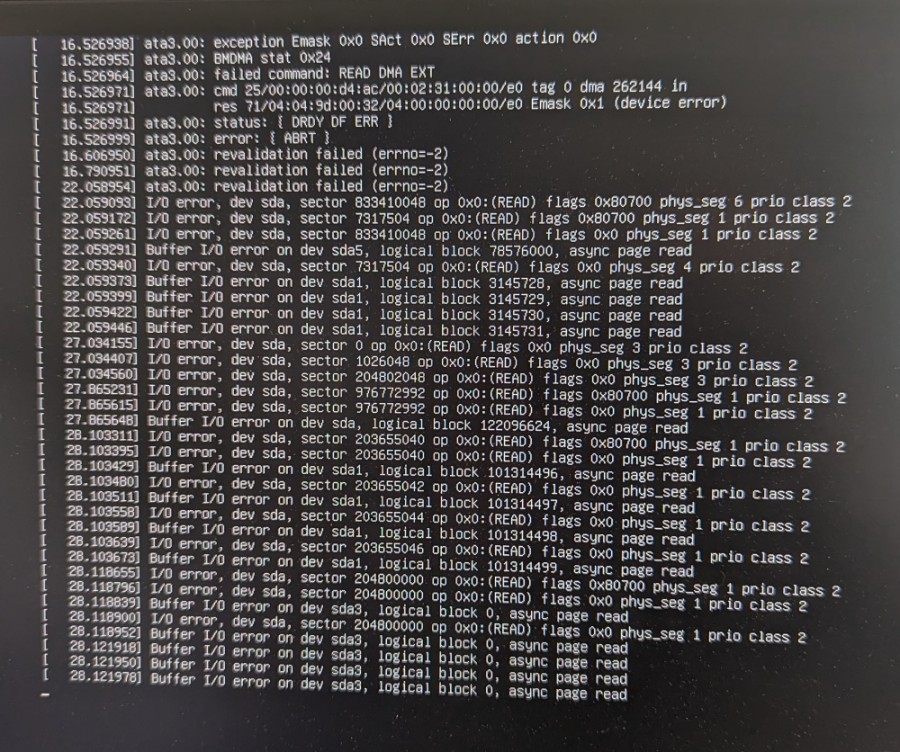

What kind of errors? File system errors or unreadable sectors?
Sometimes when booting it finds the disk (lots of errors - sda1/sda2/sda3/sda5), other times doesn't find it at all.
I don't know.

MBRWhat was the partition table type? MBR or GPT?
On a totally spearate disk.Installed where exactly?
Sometimes when it boots, the PC detects the disk, other times, doesn't detect it at all.I don't know what "intermittent access" means.
(See attachment)What kind of errors? File system errors or unreadable sectors?
Windows had an "automatic repair" that kept repeating.... Not sure if that could have been an indication that the disk was going bad? But, Windows does that anyway,,,

- PXL_20230105_232944888.jpg (262.31 KiB) Viewed 4991 times

I am not familiar with this type of log but it appears to me like unredable sectors.

That is a screenshot of output, when booting the gparted iso, to give access to testdisk & photorec...
