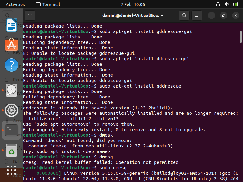

On ddrescue I don't see the drive as recognised. When putting in "ddrescue /dev/sdb sdb.dd sdb.log" It says there's no file or directory.
I also try download the ddrescue gui version but this says not in file location
ddrescue no directory.png (139.85 KiB) Viewed 20327 times
You should combine that with administrative rights "sudo" and you should exactly specify the target location by keying in a full path. Make sure that your target is bigger than your source disk when writing into a file instead of duplicating onto another disk.
The gui version is not required.

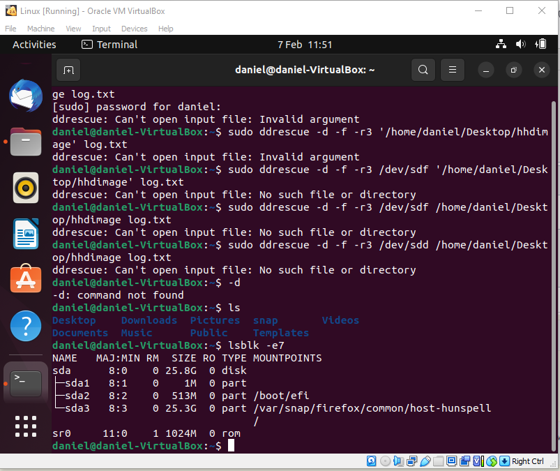

With ddrescue I am using sudo. The disk is not being recognised so I cannot see if the drive would be /dev/sdd,sdf,sr0 etc.
As for the file path I copied and paste the destination folder into the terminal.
Use lsblk without any parameters and gather identity details either with hdparm oder "smartmontools -i".
Your drive is about to die according to the attached log file. Duplicating the drive is strongly recommended.
Stop using your virtual environment. Use a pendrive linux like Gparted CD, Systemrescue CD, Knoppix or others to execute ddrescue or connect your drive to a linux machine.
If your drive remains invisible in Testdisk even in this recommended setup contact a professional recovery service.
You can always rerun ddrescue using your old logfile which is know called "map file" in the ddrescue manual. I would not use the -r parameter.

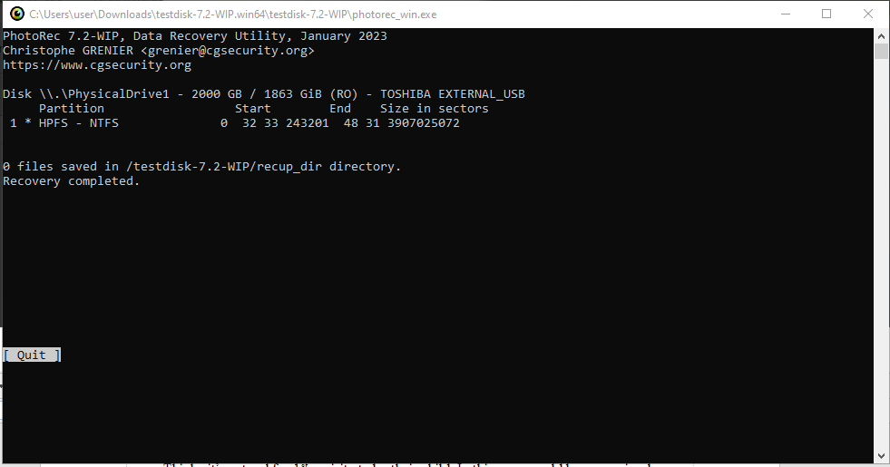

I am trying to follow each step but I can't understand without a step by step walkthrough when I don't know how to do it, plus hardly anything works so makes it worse.
I have tried to make a copy with photorec I do not think any files were saved in the directory. Only thing in the recup_dir files is the attached report.
using the lsblk doesn't show me the external drive.
I can get the drives to show on testdisk and photorec but I don't know how to recover the data, copy the data, or fix whatever is wrong with the drive
